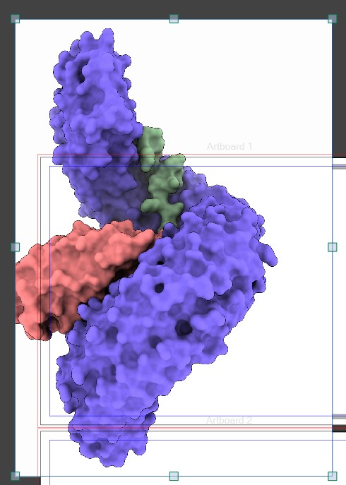

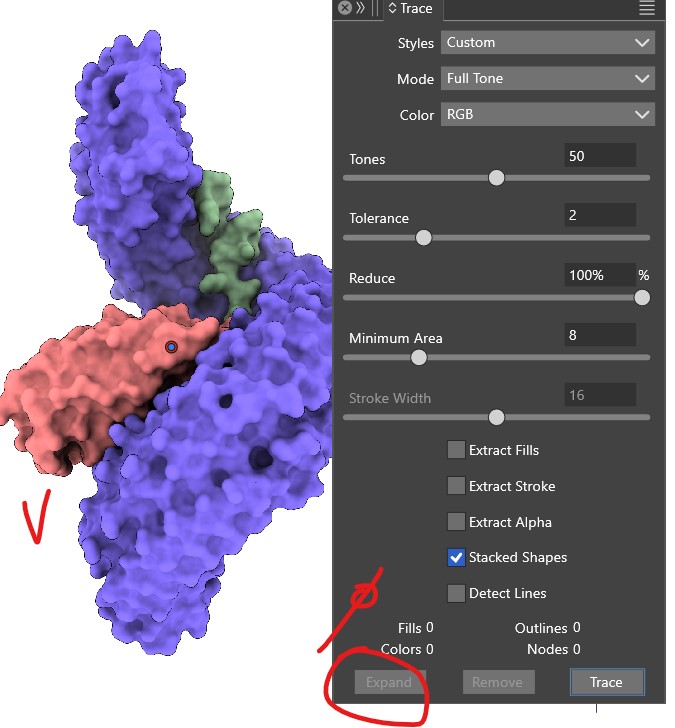

@Pat Got the file. The image was not yet traced (it also looks too smooth to be traced in the screenshot).
@VectorStyler said in Image tracing ??:
Agree but when "Extract something" is unchecked, VS doesn't trace although it seems so...
@Pat said in Image tracing ??:
That is true. In that case the trace button should be grayed. I will fix this.

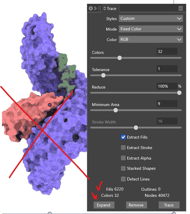

@VectorStyler Yes, too good to be right

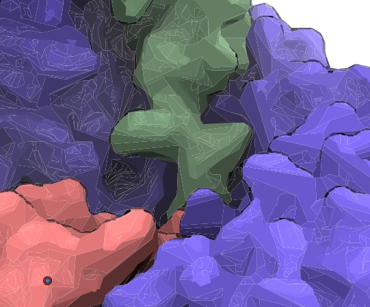

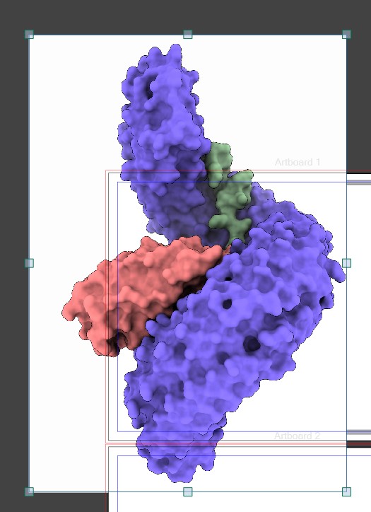

Whatever options I choose the results are not good, I can't manage not to have these lines. The results are unusable for me:
@Pat The lines are caused by anti-alliasing of touching shapes.
Is it possible not to have all these lines, as the result could even be of better quality than obtained with AdI?
There are also many options with combinations that are impossible to test all in a workflow with limited time.Original/VS/AI:
The only way to not have those lines is to turn off anti-aliasing with View -> Subpixel -> None.
Same when exporting to images, the anti-aliasing can be turned off in the export settings.This is a rendering artifact from the type of anti-aliasing algorithm used in VS (similar thing happens in Affinity also).

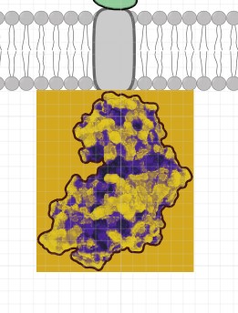

@VectorStyler Thanks but not obvious to find, & when exported as eps, there is an issue with image effect (color mapping):
In VS (ok):
In AD:
color mapping
You can use a vector effect for color mapping (in the Effects menu, first section).
I will test what happens with the image export to EPS.
@Pat Image export to EPS: image mask might be missing (not supported) try PDF.
