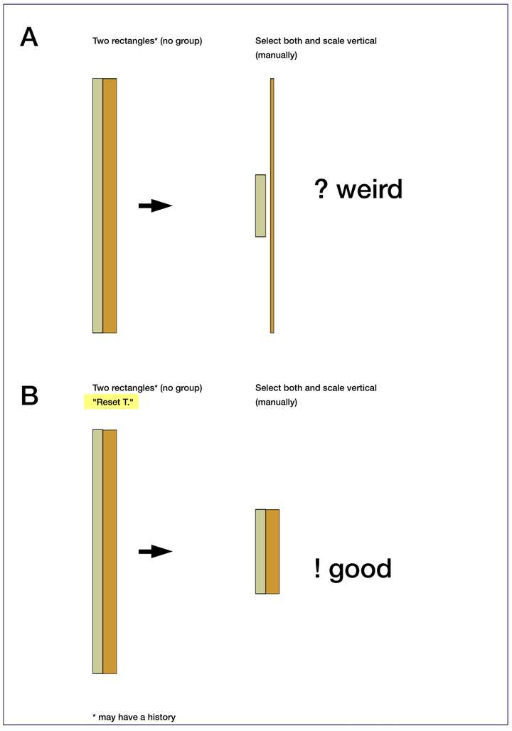

@Ayo what are the steps to replicate the case "A", that sure looks like a bug.

As stated in the footnote; objects may have a history.
While sketching I can't keep track of how an object comes into being and what its history is.Send you the file by mail...
Action is simple:
– select both rectangles
– pick center bottom bounding box
– + ctrl
– drag to scale vertically
@Ayo I cannot replicate this. Send me a file with those rectangles.
I did!
@Ayo It is a bug. Disable "Direct Shape Transform" in Settings -> Editing, then it will work correctly.
I will try to fix this ASAP.
