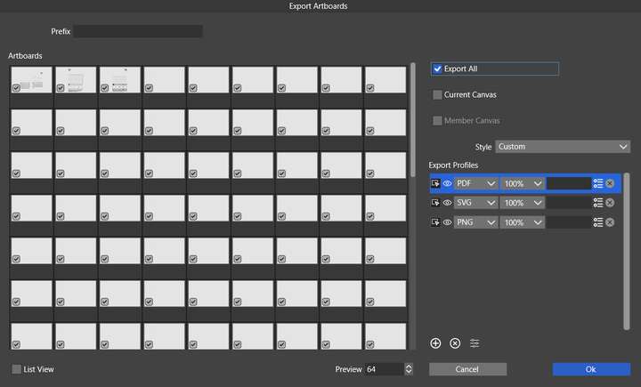

          I appreciate this new feature in the 1.2.042 version but have a problem using it. I'd like to do it fast - like checking "Export All" and then excluding empty artboards.
          For example - I have 200 artboards to export including 50 empty ones I'd like to exclude.
          How to do this fast with the "Export Empty Artboards" option?
          Maybe the logic behind the "Export Empty Artboards" option should be inverted to "Exclude Empty Artboards From Selection"?
            VectorStyler @Harry
            @Harry If you check "Export All" and uncheck "Export Empty Artboards" then empty artboards should not be exported even if they are selected in the list.
            • H Online
              Harry @VectorStyler
              @VectorStyler said in How to skip empty artboards while exporting?:
              Ok, It works. I had some empty texts on those artboards.
              It's a bit confusing now. I think it would be clearer if the "Export Artboard" panel didn't show excluded (empty) artboards.
                VectorStyler @Harry
                @Harry said in How to skip empty artboards while exporting?:
                The way it works now: the artboard export settings can be saved and recalled as presets and also using the Export Again.
                If the the content of the artboards is changed, the "Export Again" will also adapt to the new empty/used artboards, if they were selected.
