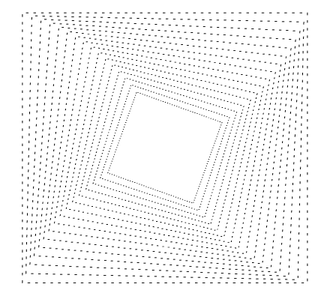

 Here is a Tutorial of mine, in VS its also possible
 to create a Pattern Brush from one or more Blends.
 https://www.vectorstyler.com/forum/topic/2089/playing-with-blend-in-pattern-brush/11

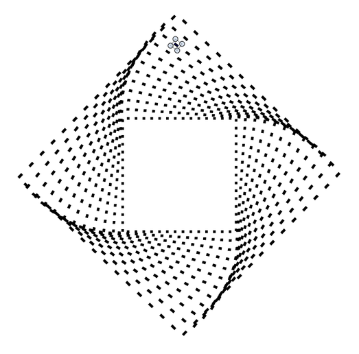

 Here a Dashed Strokes
  converted in curves/paths

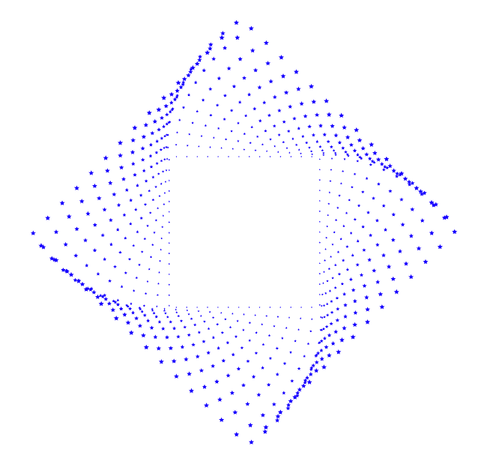

 these paths now with any shape you like.
 By using the Find/Replace Feature in VectorStyler.
 Dashes converted in Paths
 Paths replaced with Stars
