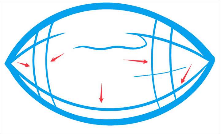

        @VectorStyler I was testing a similar issue I am having with the knife tool - but in doing so, realized the issues I am having with both tools is when I try to use the knife tool or the path eraser on interior shapes. If the shape is not enclosed, the path eraser works perfectly - as does the knife tool. They naturally separate the two new objects perfectly.
        Is there a way to fix this so using the path eraser and knife tool can create clean cuts/deletions when used on interior enclosed sections of a path shape?
