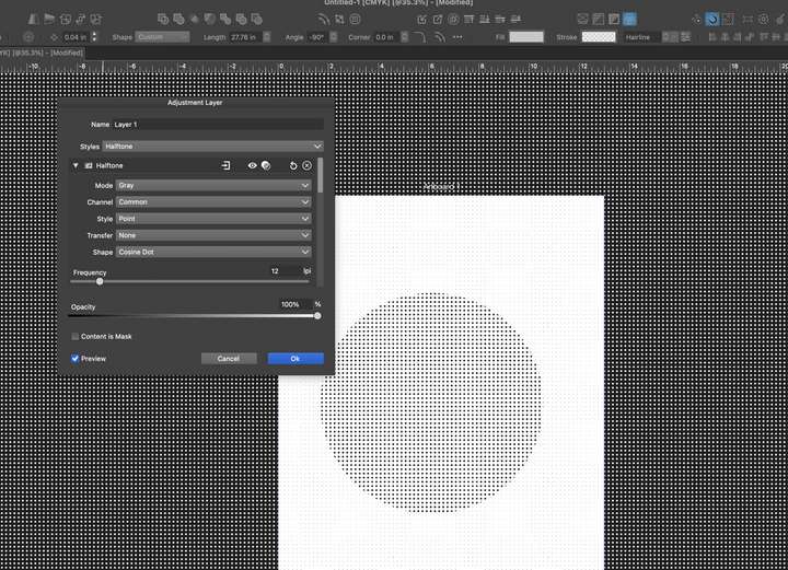

      Is it normal for the adjustment layer pixelate halftone option to render the canvas and artboard and vector object as a halftone? is there a setting i need to adjust?
      0_1722194476696_61e83633-7f41-4733-8d53-923a90000ba7-CleanShot 2024-07-28 at 15.20.54.png
        @Boldline It will render the whole visible (or exported) area. This is basically the whole layer, the artboards are just guides for printing / exporting (Same goes with any other drawing).
        Adjustment effects can be restricted to an area or any shape, by drawing an object, adding the effect ti the object (as a regular image effect) and turning the object into an adjustment layer (in Object Options)
