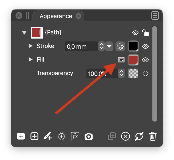

@Gremriel A temporary fix for combine results: select the object and in the appearance panel set the winding mode of the fill style. Clicking on the icon alternates between even-odd and winding mode fill.
@vectoradmin said in Combining text with a shape does not work:
That seems to do the trick. Thank you.
