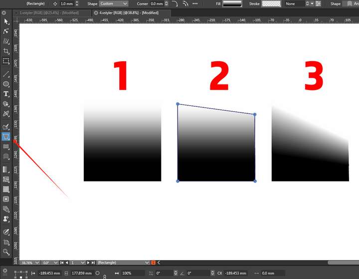

      0_1720882348296_mmexport1720882074406.png Can the deformation function on the left support the deformation of the gradient?The effect is as 3.
        VectorStyler @monsterfox
        @monsterfox Not directly with shape effects.
        It can support if mesh gradient is used (it is possible to do a mesh that looks as 1).
        The mesh gradient nodes are distorted by shape effect.
        The 4-point distortion shape effect has an image effect version also. Open the Image Effects panel and the [+] button has a Mesh menu with the 4-point effect in it. But these are heavier to render and to work with.
