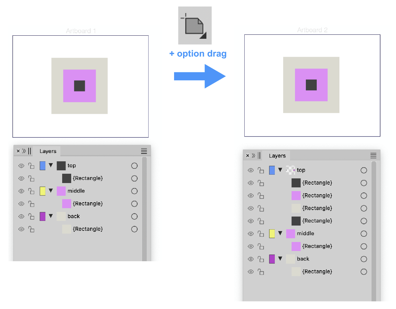

How to keep layer contents buildup when duplicating artboard
How to keep layer contents buildup when duplicating an artboard (alt drag artboard tool). All my artwork on my layers 'top, content and background' are moved to top layer in stack when duplicating artboard.
@Ayo Yes, this seems to be a bug. It should duplicate top level layers only, with the content overlapping the artboards.
@VectorStyler I don't understand.
What do you mean by 'only top level layers'? My question is just very simple and is a basic behavioral expectation.Visualize it then, just to be sure
@Ayo Yes, I understood the question. The problem is that is is not working well in VS, all duplication will go into the current layer, and it should not.
Well then we have a major issue in my opinion.
Good luck!

@Ayo A fix will be in the next build, it will affect the move tool only (for now). Copy paste has different options (similar to AI).
