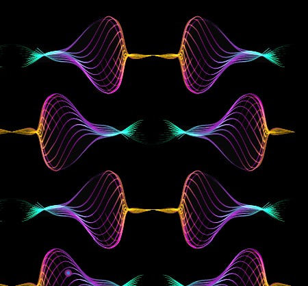

I've got a patter that I'd like to keep as it is:

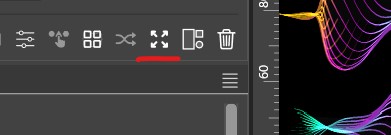

but when I expand it:
the objects change shape. What do I miss ?
@Pat Not sure what could cause this. Can you send me the file with the example (before being expanded).
@VectorStyler File sent
Could you also test svg & pdf export? The result are not great.
Thanks
@Pat Got it. The workaround for the repeater expand is to use first a Convert to Curves (to flatten the scaling) and then do the expand. I will fix this
