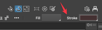

  • @Ingolf Not every potential variable option can be added to the UI without it looking bogged down and complicated. There's a solid number of designers who utilize the fill shapes with pencil tool for most of their work and a solid number like yourself who would primarily use it as a stroke only and choose to fill in the resulting shapes in a later step of your process.
    The option already exists on the contextual menu bar to choose a fill and/or a stroke for the pencil tool. If you know for sure you'll never want to use the fill with pencil tool, then that option is available to set permanently. If you want the fill option occasionally, then set it to allow for fills and then modify the fill/stroke option in the contextual menu. We already have that expectation with other tools - we check the settings in the contextual menu before we go about using them.
    I primarily use the pencil tool as an immediate fill and I just check that fill is set and I go about my use of the pencil tool. If I occasionally need a stroke-only pencil tool result, it's easy enough to make the choice already without digging deep into the settings each time
    0_1713575160088_8d766096-d8e5-4d49-8ecc-d743f5c04ffb-CleanShot 2024-04-19 at 21.00.43.png
    @Ingolf said in Pen tool - fill shapes usability:
    I still strongly recommend that this setting be somehow brought forward in the user interface for the pen tool;
    I will try to find a solution for this. The context panel is a bit loaded for the pencil tool (npt much room left).
