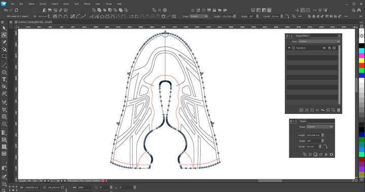

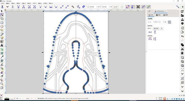

      Inkscape is an open-source software.
      Although it is not yet mature, there are still many aspects that are worthy of recognition.For example, in terms of anchor points, I hope VS can learn from it.
      https://gitlab.com/inkscape/inkscape/-/merge_requests/6288!![0_1713538645531_mmexport1713538616793.png](/forum/assets/uploads/files/1713538649377-mmexport1713538616793-resized.png)

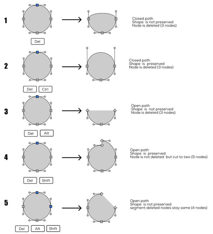

        VectorStyler @monsterfox
        @monsterfox I will add this to the backlog. Similar functions exist in VS also, but not with shortcuts. For example, selecting a segment (not a node) and deleting will break the path (as in 5).
        • M Online
          monsterfox @VectorStyler
          @VectorStyler In the second example in this picture, the effect of Inkscape will be better.After deleting an anchor point, it is able to more completely restore the integrity of the graphic.VS will fall behind a little.!
          • M Online
            @VectorStyler 0_1713570575674_mmexport1713569321653.jpg There is also room for optimization in the center color of the curve and the size of the anchor point. It looks quite strenuous if it is not this pure white background.0_1713570581506_mmexport1713569317178.jpg
