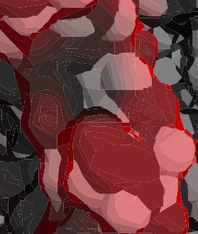

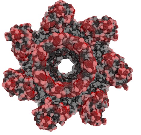

 I'm trying to trace a bitmap image (png file) but despite numerous attempts, I can't manage to avoid having these fine white lines everywhere, even though there aren't any in the original image.
 I'm certainly not applying the right settings, but there are plenty of parameters to test nonetheless. Any ideas/tips on how to avoid this while preserving the nuances of the original image? Thanks
 @Pat This is caused by the anti-aliasing when rendering touching shapes.
 The anti-aliasing can be disabled in View -> Subpixel by selecting None.
 @VectorStyler said in Tracing a bitmap image: @Pat This is caused by the anti-aliasing when rendering touching shapes.
 The anti-aliasing can be disabled in View -> Subpixel by selecting None.These lines disappear in the viewer window but, as I suspected, they are always present in an exported file (jpeg or pdf).
 @Pat said in Tracing a bitmap image: These lines disappear in the viewer window but, as I suspected, they are always present in an exported file (jpeg or pdf). In the Export panel, try to turn off the Smoothing by selecting "None".
