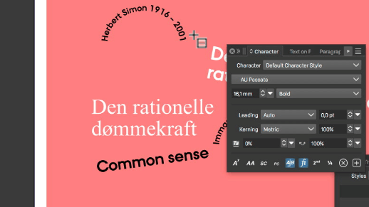

No response when changing font specifications
I can't change font type and specs in certain text strings, but other texts works as expected. File attached
Have I missed something? Is it by design or a bug?
Kind regards,
Raaskot -
@Raaskot All three cases worked here, not sture what could cause this.
First, try changing the font from the context panel (upper row) to see if this is caused by the character panel.
If that is not working, the reset the app to default settings/workspace (I always run the defaults in these tests).
Let me know if this works.
No difference whether Menu, Context Panel or floating panels.Tried reset to default:
- Better, yet still acting weird. If I cmd-A and enter new font nothing happens.
- But when drag select isolated word the font will change.
@Raaskot Found the error. It was the Cmd+A that I missed. I will fix this ASAP.
Meanwhile as a workaround, for changing the font of the whole text, just select it with the transform tool.
