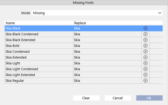

I will open an issue around missing font replacement when using variable fonts.

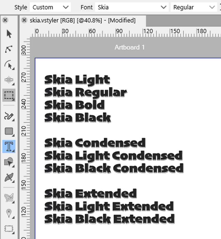

Also if there are variable fonts installed, these should be visible in the font list with a "VAR" icon."VAR" is shown, but oddly the style that is actually rendered for any style that is specified is "Black Extended":

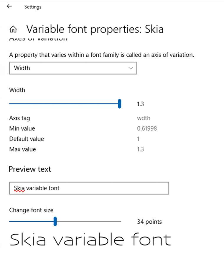

The font itself seems to work fine on Windows, this is when adjusted with variable axis in Windows font settings:
