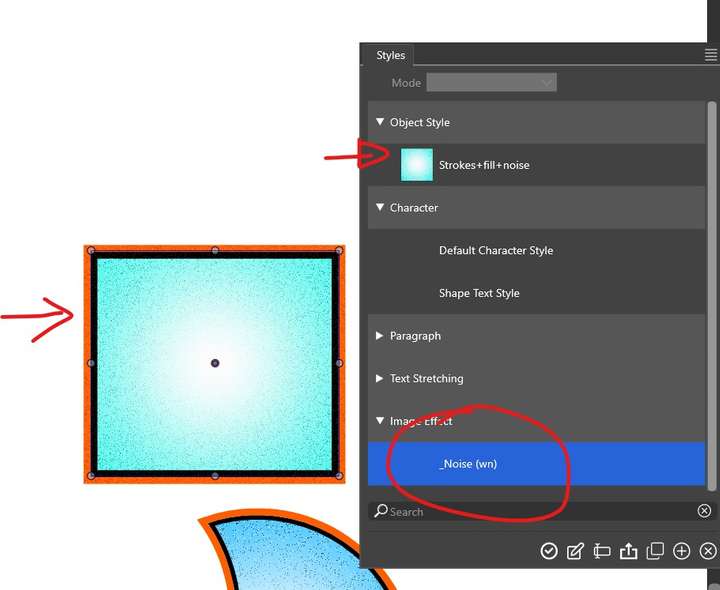

      B-Vs-V @VectorStyler
      @VectorStyler no, I don't see how it works and when I select an object with the object style, in the style list, what becomes selected is the image effect (noise), impossible to maintain the selected object style:

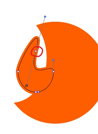

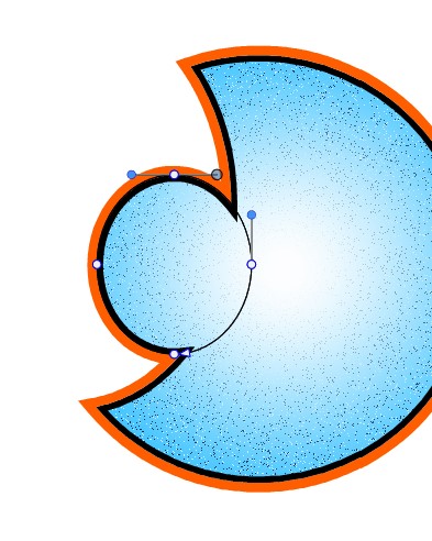

          @VectorStyler Got a bug I think:
          Ok:
          Not ok:

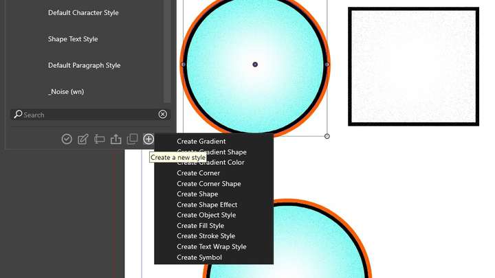

            VectorStyler @B-Vs-V
            @Pat This is the Styles panel: the "Styles" are linked, so when an object is selected its used styles are highlighted in the panel.
            To update styles here, the selection in the panel must be changed after the object is selected.
            I got the file, and it seems there is an offset path error with the stroke alignment. I opened a bug on this.

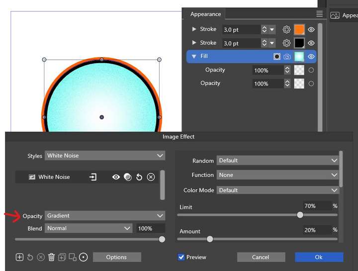

                @Pat I will try to create a better explanation, but in the document I got in the Styles list there is no Object Style or Image Effect style, probably was not saved.
                  @Pat Found the image effect, here is a recording of how to update the Object Style: https://recordit.co/grpBAFqEso

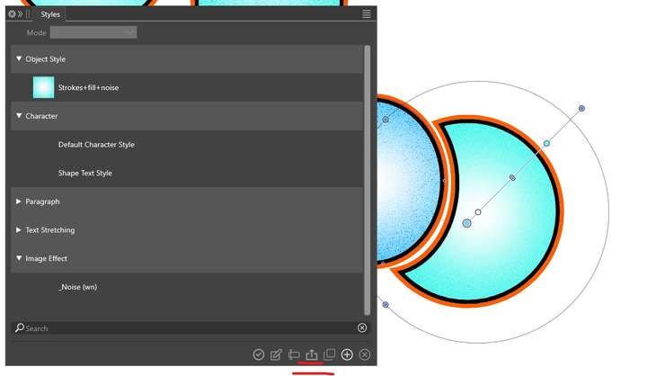

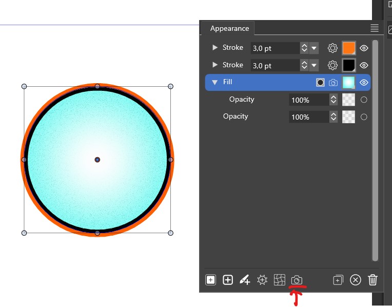

                    • B Offline
                      @VectorStyler No, I can't get it. I did watch carefully your video: I first select the object and then the object style in order to update the style... but doing so, I do change the object style before I can even change the style. Well, I'll try with another new file later.

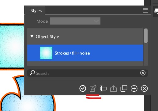

                        @VectorStyler Also, why can't I edit the style:
                          @Pat said in Adding white noise to a specific color in a color gradient:
                          Yes, it means that in the panel menu "Listing Mode" the "Edit on Double Click" is enabled and apply is done on single click.
                          In which case, updating will not work (conflicting settings). Enable "Apply on Double Click".
                          There is also "Update from Selection" in the Panel Options, that can be used to disable automatic highlight on object selection.
                            Object styles contain all sorts of attributes of an object and they cannot be edited in a separate modal view.
                            • B Offline
                              @VectorStyler Thank you ☺
                              That's what I was doing but had forgotten about this single/double click... hence my lack of understanding.
