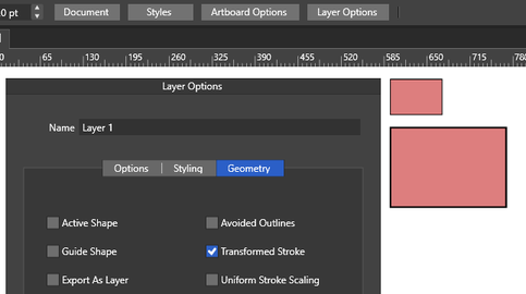

    What settings do I adjust so not to scale the stroke size when editing width/height?
    5 Posts 3 Posters 6.0k Views 2 Watching
      If I am working with shapes and I am editing the width or height specifically, but not scaling from a corner of the shape, what settings to do I need to adjust so it does not scale the stroke size as well?
      S VectorStylerV 2 Replies Last reply Reply Quote 0
        Subpath @Boldline
        @Boldline
        check Layer Options
        transformed stroke
        there is the same setting in
        Document Options too
          Boldline @Subpath
          @Subpath Thanks for the response. I tried both of those and the problem still remains
            @Boldline There is also a Transformed Stroke and Uniform Stroke Scaling option in the Document Setup view General tab.
              Subpath @Boldline
              @Boldline
              changing only the setting in "Layer Option"
              is working here
