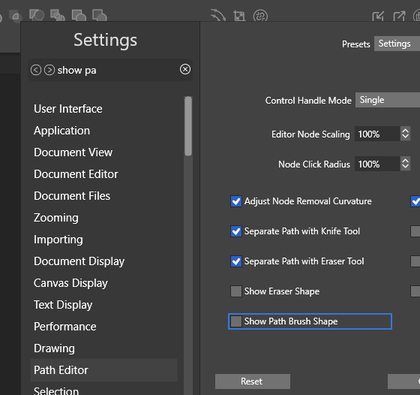

@Vivek In settings, search for "Show Path Brush Shape", and enable this option.
Thank you for the response. I will do that.

It is in Menu (VS 1.2 beta)
Edit > Settings > Path Editor > Show Path Brush Shape

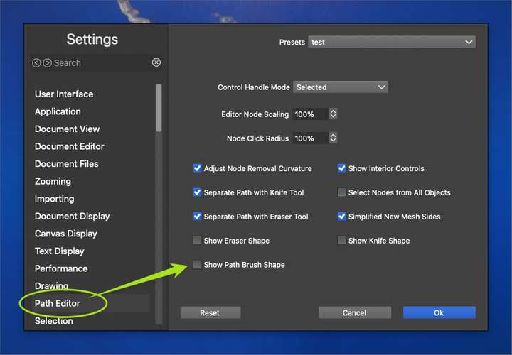

@Vivek Welcome to the VS forum community! If you go to the settings panel for vectorstyler and look on the left side for the "Path Editor" section, you'll see the checkbox @VectorStyler was referring to.
Vectorstyler is a deeply customizable program so its easy to get confused at times where to find settings. It's come a long way in a short time.

@VectorStyler: I am using VS 1.1. I reckon it is in 1.2 Beta?
Don't answer that: I found it! Thanks to @Subpath and @Boldline's screenshots!
