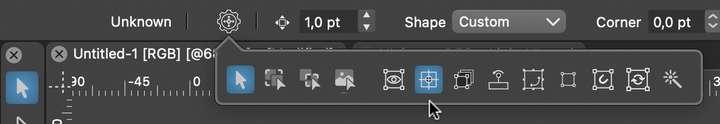

        @FastVector I'm not familiar with AD so I guess I might misunderstood something,
        but in VS the transform pivot can be edited when this button is enabled:

          Yes I know you can. But you can't move the pivot point any more when for example you open the rotate panel (Shift+Alt+R). The only way is to do it before you open it, or close the panel and change the pivot point and then reopen the panel.
          Hope it makes sense.

            b77 @FastVector
            @FastVector A modal windows like 'Rotate' here "traps" the focus.
            Not sure how to solve this — perhaps including the CX and CY fields
            from the Transform panel?
