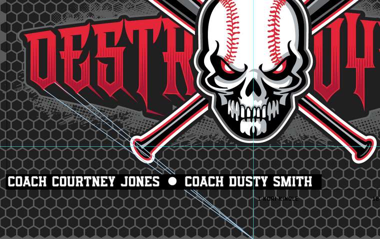

      This may already be in there - but I was trying to create a perespctive look on text but would love a tool I could set my guides to automatically where it allowed me to set the axis and add a set number of guide lines and be able to slide the guidelines up and down along that axis and also allow new strokes and pasted object to snap to that guide.
      Illustrator has a 3d effect which I would also like to see a better version of in VS eventually - one thing I wish they had in their version was an easy way to make these edges in the perspective chosen. Right now when you use their 3d tool, you get left with a bunch of shapes and you have to go in and manually figure out where you can add lines. 0_1617122876492_BLD 2021-03-30 at 12.43.38.png
        @Boldline Could rotated guidelines help with this one, as a workaround?
          @vectoradmin Are rotated guides something you already implemented or are you thinking ahead of a temporarily solution that could be added in the next beta? that might be a decent fill-in solution...
            @Boldline Has been there from the start 🙂 Guidelines can be at any angle. Hover over the guideline close to the view margin and it will rotate when dragged, instead of moving. Also: angles can be set in the guidelines panel.
