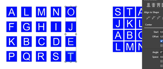

                @FastVector Using the alignment panel is also possible, but it is too slow.

                    Subpath
                    @FastVector , @Li-Xiao , @VectorStyler
                    Found "Block Stretching" in Alignment Panel, also new to me
                    but looks kind of helpful for such a Task in the meantime
                    Sometimes the order of selection matters, so keep an eyes of that
                    Here the video
