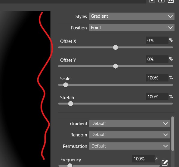

Shape effect, option panel

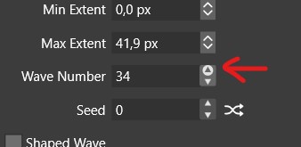

I don't think this is intentional: the pointer simply needs to be above the top arrow (without clicking) to increase the value continuously (Shape effect, noise wave).
@Pat I could not replicate this.
Is this increasing (scrolling) the value, without clicking first?
There was a similar bug posted with the number scrolling.
@VectorStyler Yes, it is.

About the scroll knob: after clicking inside the number field, does the scroll-by-hovering issue persist?
@VectorStyler OK, but I misspoke: is this permanent for all future documents? Can I save as new "noise style" through this windows after the changes?
I had closed VS and now it is fine... but I can change the angle by clicking next to the number field window (always from "0°" to "-90°").
Scrolling with the mouse wheel in the same row will change the value (by design), I see what can be done here.

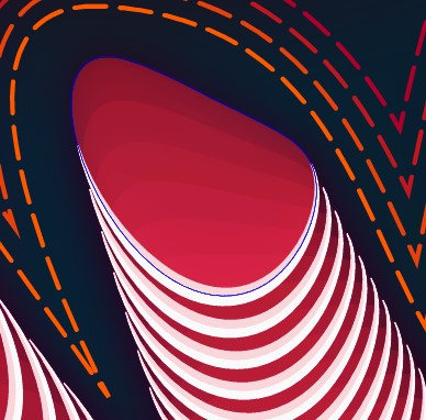

Also, I'd like to change the size of a complex blended object and I can't find the option to adapt the strokes. They keep their size and all the object's nuances become masked by the strokes.
@Pat said in Shape effect, option panel:
I seem to remember that with Adobe Illustrator, all one had to do was place a shortcut from another directory, even from another hard disk, in the default directory and you had access to all the stuff (brushes, etc.) one had created. Is it the same with VS (sorry to ask before testing myself).
Yes, this is the same. In Styles -> Preset Manager click Create Group. Give a name and select a folder. Works for VS preset files only.
Group the blend with its two sources and on the group enable Object Options -> Geometry -> Transformed Stroke.

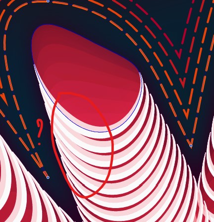

@VectorStyler Well, it is not ok...
Before:
After [Object Options -> Geometry -> Transformed Stroke]
@Pat I opened a bug on this one.
Are these stroke styles inside a blend object?
@VectorStyler yes, it is.
I've sent you this file before, but I can send it again if you need it.
@Pat Please send it again, the version on the screenshot.
@VectorStyler File sent
