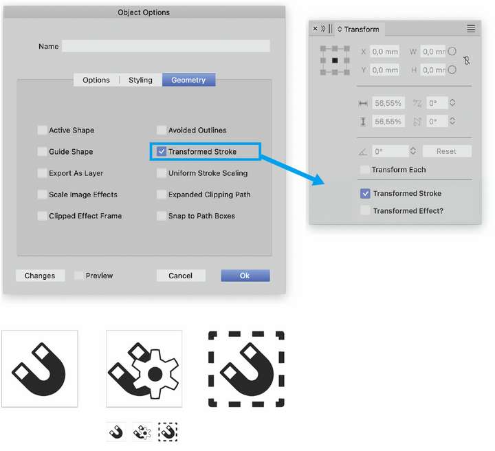

        • AyoA Offline
          Ayo @VectorStyler
          @VectorStyler said in Scale Stroke:
          Transformed Stroke option
          Never again can I scale my icons as a whole after I have created them as 'Transformed Stroke option' only works for new objects. Simply moving buttons to the Transform panel does not work either. The problem lies deeper. ☹
            VectorStyler @Ayo
            @Ayo said in Scale Stroke:
            It is also possible to enable for groups or layers.
            • AyoA Offline
              Ayo @VectorStyler
              Allright!
              The great thing is that it doesn't have to be group. Also works for me for a simple single stroke!
              Can this button please be moved?I think you'll please many people with that.
              b77B VectorStylerV 2 Replies Last reply Reply Quote 1
                b77 @Ayo
                @VectorStyler In Illustrator it's in the Transform panel, if I'm not mistaken.
                  VectorStyler @Ayo
                  @Ayo It is in the Transform panel menu.
                  Yes, it can be moved easily, but then it becomes a bit too large panel (maybe added as a state, with the panel title knob).
                  b77B AyoA 2 Replies Last reply Reply Quote 0
                    b77 @VectorStyler
                    maybe added as a state, with the panel title knob.
                    I would like that. 👍
                    • AyoA Offline
                      Ayo @VectorStyler
                      Beautiful!
                      And the best thing is that it also works numerically, as it should when you take a position in that panel.

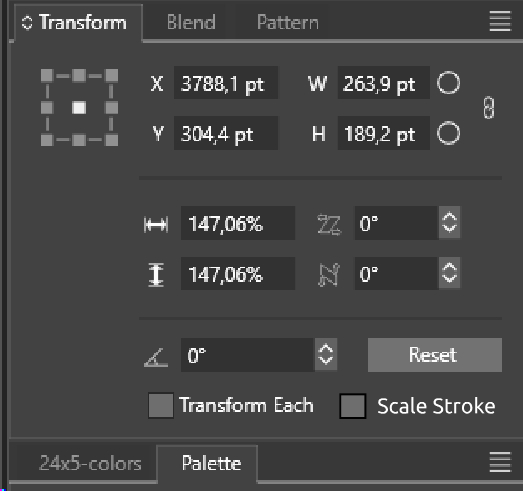

                      • F Offline
                        FastVector
                        Just wondering if this is an option. It won't take much space and the panel doesn't become larger. But because I use this quite often, it helps a lot to have it in sight, and don't have to search for it.
                        Windows 10 | 1920x1080 | 125%
                          VectorStyler @FastVector
                          @FastVector The Transform panel should have this in the 1.2 beta (click on the title up/down arrow knob).
