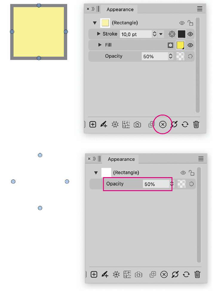

Clear all content from the object?

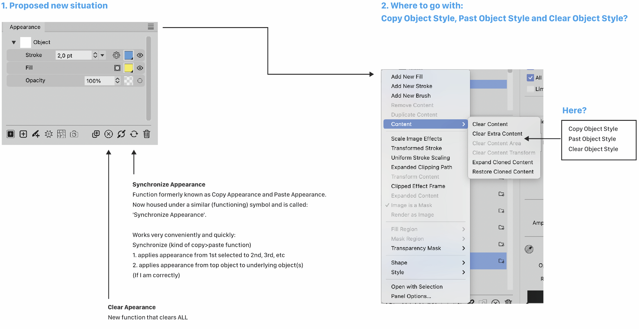

A bit dazzling. Opacity, masks, Image effects, object, content, style, apearance.
Anyway. Copy/Paste Appearance does the same as Synchronize Object Styles.
From my user perspective and experience, the behavior is not easy to understand as long as there is no disclaimer attached to it.
Cruel but a comparison.VS https://recordit.co/bwJ4clkqyC versus AI https://recordit.co/3UOc0Bv9Ft
And don't get me wrong, deep respect for the developer. And very happy with the initiative, but I am only looking for things that I feel could or should be improved.If it's my problem, you should tell me. Then I'll stop whining about this.
I sometimes get the feeling that the back-end structure is different from e.g. Illustrator but front-end design resembles it and therefore the apearance may be caught in two minds.
What about the benchmarks?
Illustrator includes the object level opacity. In 'clear apearance' and in 'drag/drop appearance object preview icon' to past apearance to new object (something equal to copy/paste appearance or synchronize) as well.
Not familiar with this, but how does Coreldraw or Affinty D deal with this?

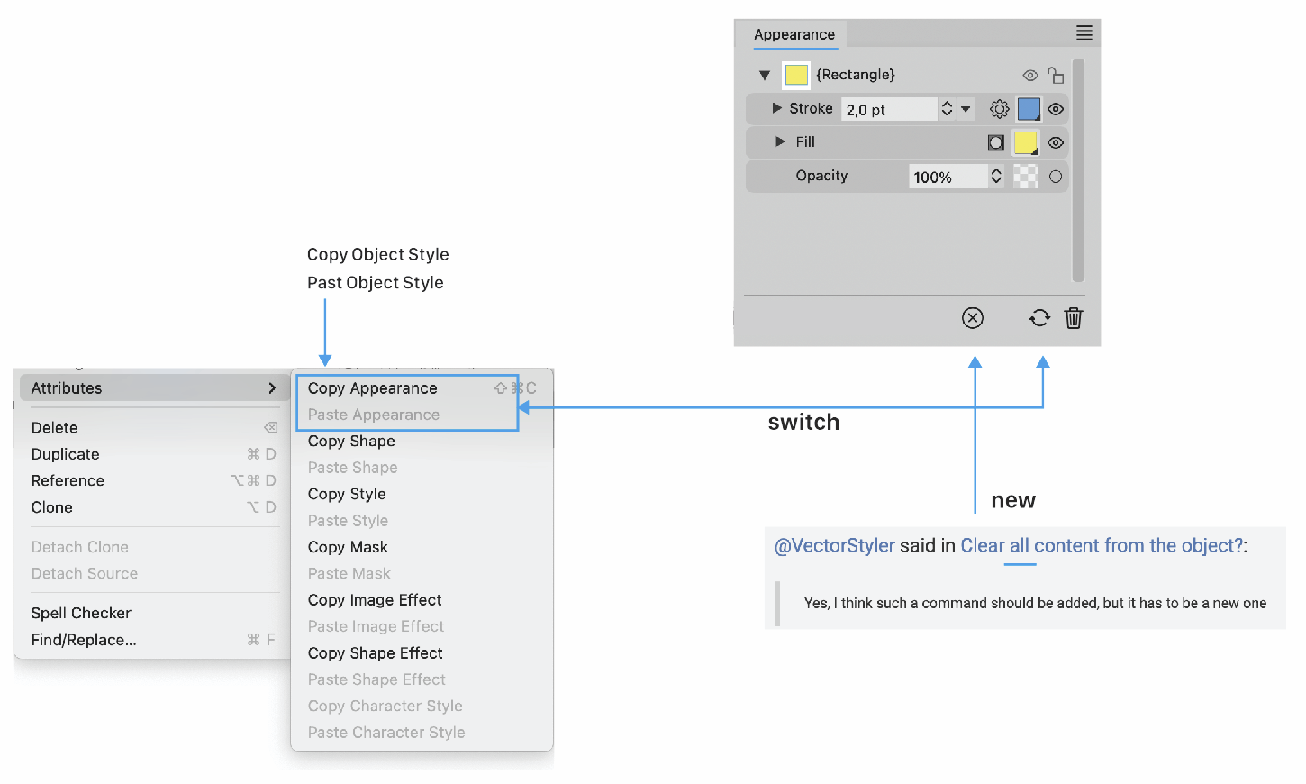

@Ayo said in Clear all content from the object?:
Edit > Attributes > Copy & Paste Appearance includes the object
level opacity — it's not the same as 'Sync Object Styles'.I'm sure the developer could include a 'Sync Appearance' button at the
bottom of the Appearance panel, but it's already full. Having Copy &
Paste Appearance in the Edit menu is good enough, IMO.@VectorStyler
'Sync Object Content' is indeed better than 'Sync Object Style'.
@b77 said in Clear all content from the object?:
level opacity — it's not the same as 'Sync Object Styles'.You're right.
Wouldn't a Sync apearance button at that position be more useful than Sync Object Style?
After all, it is the 'apearance' panel. Sync Object Style to a menu.
I mostly use 'Copy & Paste Appearance', so… maybe…
I'm curious what other users say.

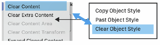

@b77
I have an idea that might fit the bill.
Tere are a bit too many buttons in the Appearance panel.
How about moving these two to the panel menu, adding copy / paste to the menu?
And adding a new button for the "basic styling" mode?
@VectorStyler More appearance under the flag appearance. Like so?
@VectorStyler
Don't quite understand these differences. Double, redundant?
Clear Content should clear all content from the object.
Clear Extra Content keeps one stroke and one fill content.
@VectorStyler said in Clear all content from the object?:
Was wondering if Clear Content isn't the same as Clear object Style.
