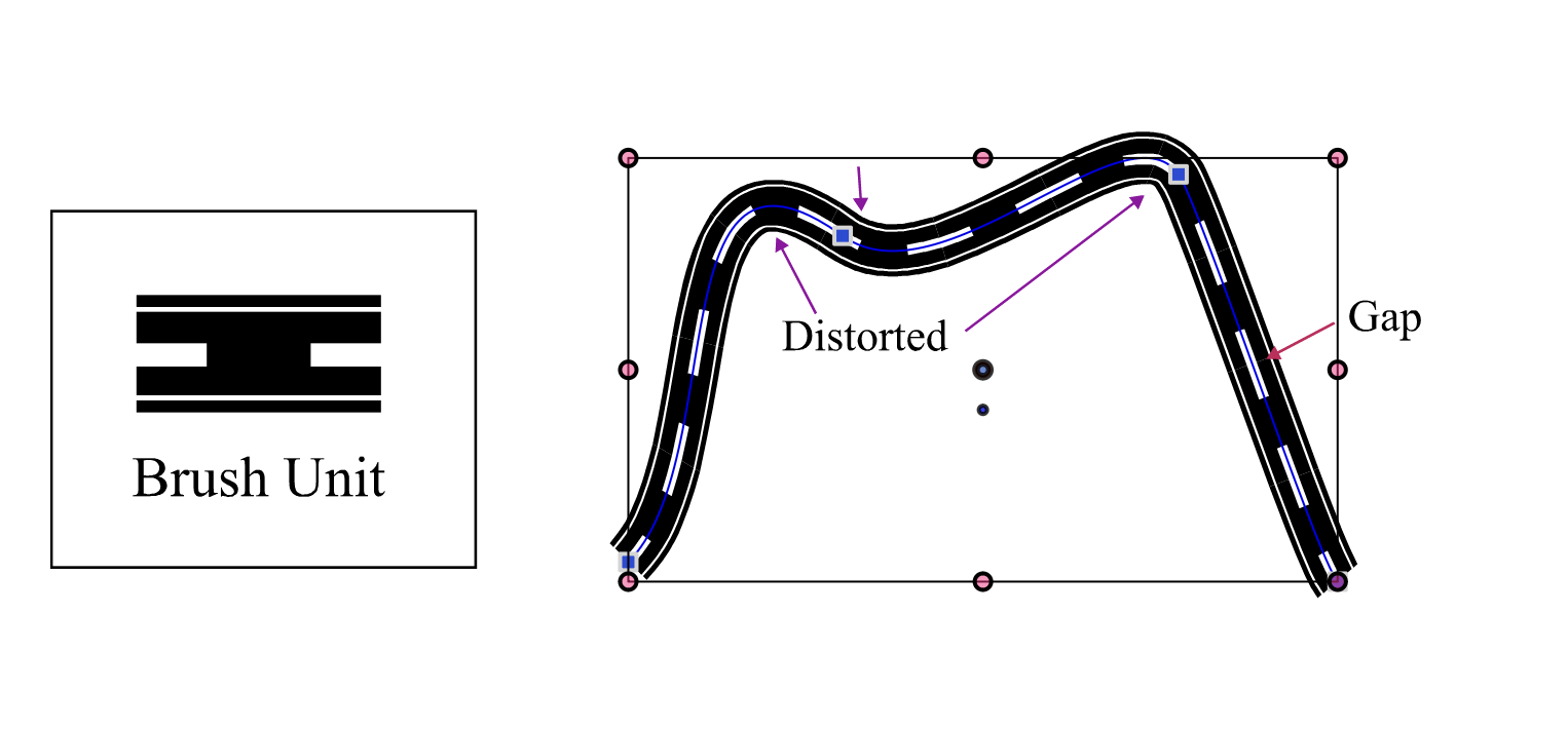

Trying to create a brush. Noticed the following.

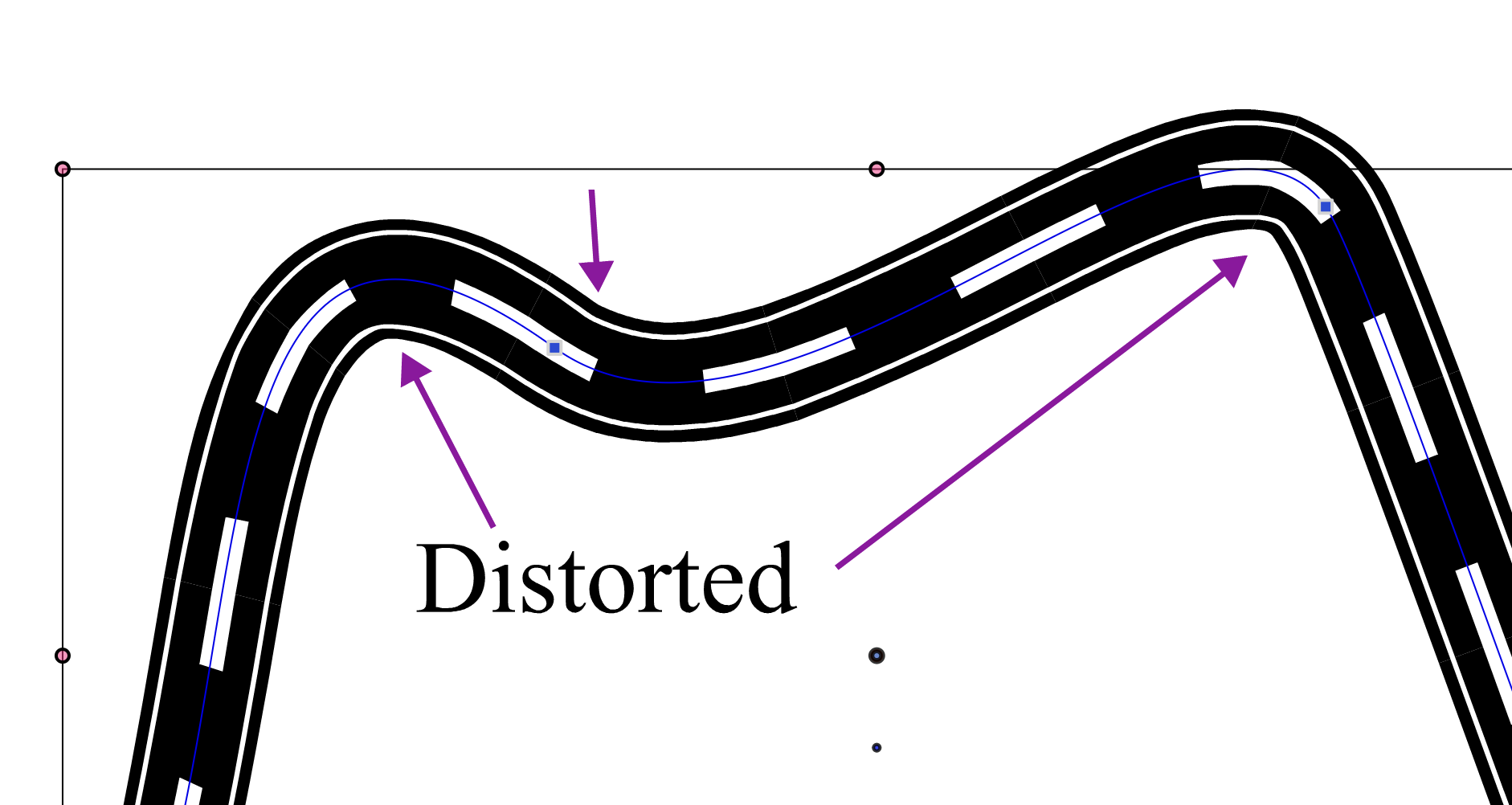

- At the curves the brush is distorted. Tried all options in the brush panel.

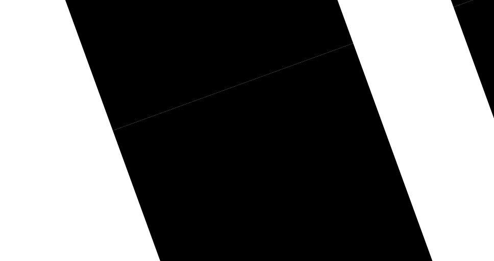

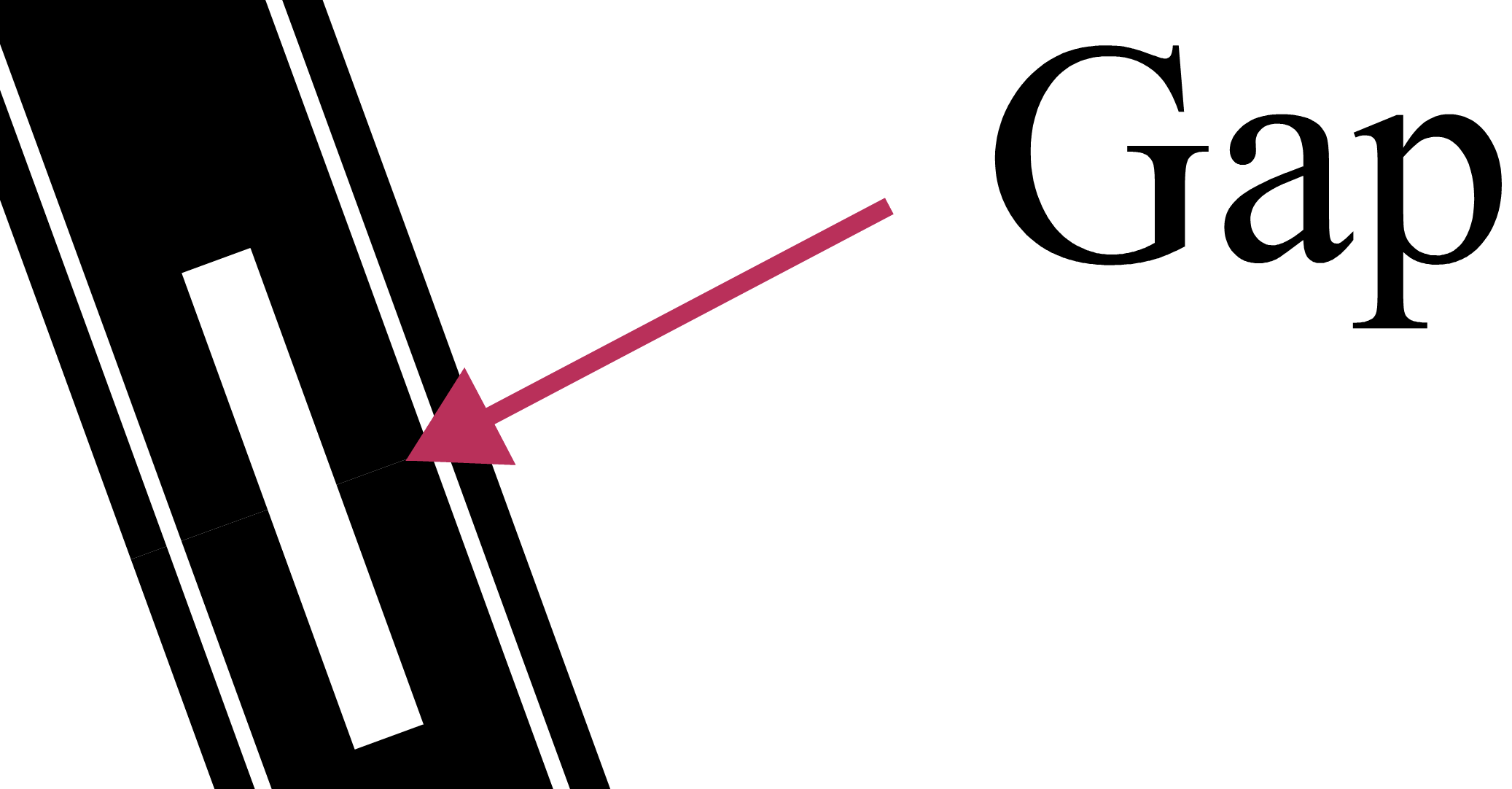

- There is small gap between the brush units. Somehow in the uploaded image the gap is not clearly visible. Attaching the VS of the same.

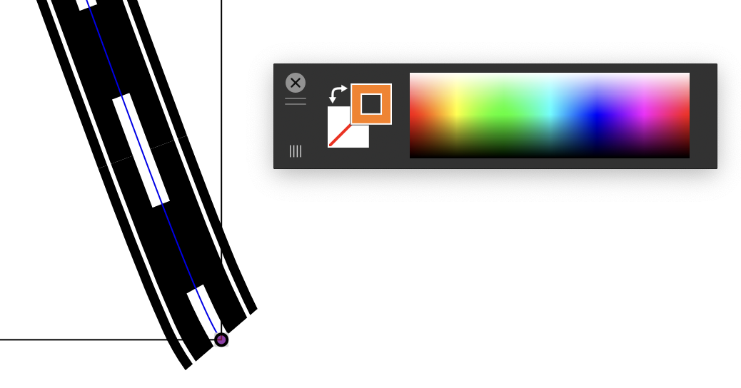

- Unable to change the color of the stroke.

@Kumr The distortion occurs because of a brush stretching artifact. I will improve this but it may result in more nodes when expanded.
The overlap is an anti-aliasing artifact, in general this cannot be fixed, but it is possible to set a small negative space in the brush options to have a small overlap (I will think of an automated what for this).
For the stroke color, open the Brush Options (button in the brush panel), and select Solid in the Tint field.
@VectorStyler Thanks.
I was able to change the color but not color gradients gradients.
@Kumr Gradient is not supported in vector brush.
