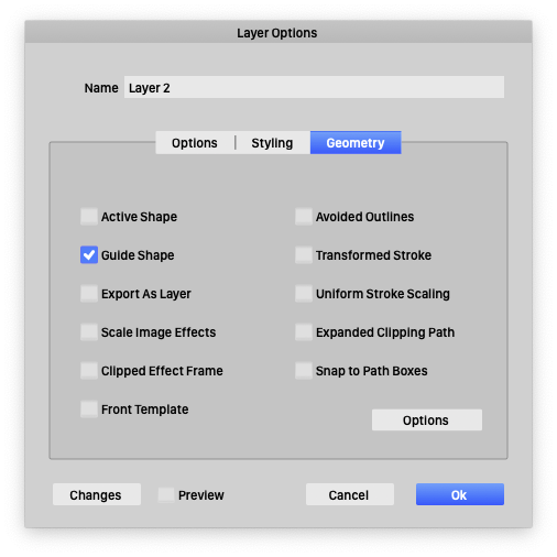

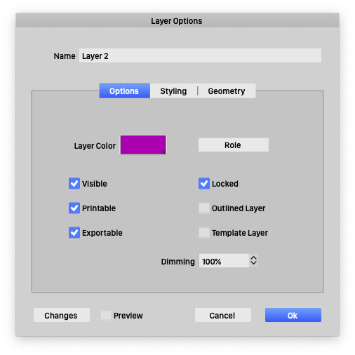

                  Slightly off topic, but as a related idea.
                  If I create a guide layer and set my own style, I could do lines, objects, and even guides that transform them (though I have no use for them).
                  This is another practical way to do it.
                  I'm eagerly awaiting a palette to manage guide objects in a future version.

                    @Boldline said in Cool ideas to add to the guides in VS:
                    The ability to cut a selected guide with the knife tool and then delete one selected section of it or the other
                    The ability to trim guides to the artboard by adding the guides while the artboard itself is selected
                    The problem in case of VS with this is that guidelines are not part of the graphics (layer) hierarchy. They are just "guides".
                    But it is possible to turn objects into guides, in which case the knife / trim tools will work
