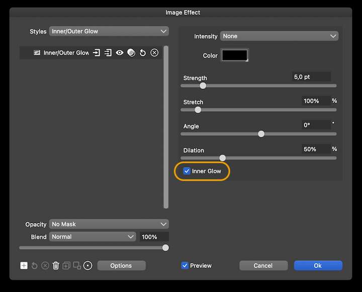

BTW: why is outer glow not outer?
@Ayo You mean the 'Inner/Outer Glow' effect?
Here it is set to 'Outer' mode by default, and if you need it set to 'Inner' mode, click this checkbox:

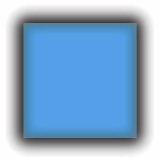

@b77 said in Alter a Symbol or Symbol Preset:
Yes and found that but the effect affects also the inside of a shape.
@Ayo Ah, got it. Could be a bug with the Dilation value, not sure.
@Ayo yes there seems to be a bit of smoothing inside, can be replicate here also.
I added this to the backlog of bugs.
