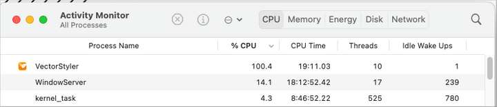

  • I've really wanted to harness the use of the repeater tool but I've been dissuaded because it does not seem to work well for me in terms of time and resources. Has anyone been able to create repeater patterns and not have VS completely stop working in the process? I have an M1 Mac with 16GB of ram, and while it's not a ton, it seems like it should be sufficient. I certainly leave a lot of room for it being user error on my part
    I created a gradient sketch and imported it into VS as a png file. I selected it and have been trying to move it around and then also expand it and edit it, but any arrow key nudge or attempt to expand takes all of the CPU power for extended periods of time. The png file is 1.1 MB in total.
    It might be easier to just send the file to you @VectorStyler and see if you have the same issues I am dealing with with the repeating result. It's too big a file to post on the forum
    I love the repeater tool and want to utilize it daily in my work, so as frustrated as it's made me today, I'm anxious to resolve the issue

    @Boldline I will try to solve this ASAP. The repeater might result in a large number of objects.
    @Boldline Tested with both files, and indeed it is slow here also.
