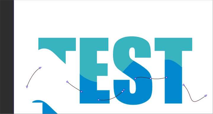

  • I was experimenting with the shape builder and noticed that when using the tool on expanded text with a path used to create a selection, it is a destructive action - in that it replaces the original shape completely and also removes a section of the path used to divide it. I also noticed that it creates a stroke on the resulting new fill shape.
    Would it make more sense for this to have the option of being non-destructive? So the new shape created sat overtop the original and the path used to define the new shape in part remained a solid?
    Is there a way to have the option not to make a default stroke around the new shape?
    0_1676843442285_ea699a04-bf26-4c99-8b76-c1951117939f-BLD 2023-02-19 at 16.50.33.png

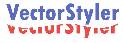

  • @Boldline
    Do not really know what you are searching for
    but i like to mentioned clipping group offers
    also a possibility.
    (Note: Clipping with editable Text seems to have a bug by now.
    Therefore I converted the text to curves, ungrouped it
    and then combined the letters).
    The clipping group
    Clipping group after expanded
    ( Menu > Object > Expand clipped groups )

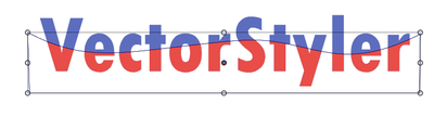

  • @Boldline
    here my try, with "expand clipped group".
    looks similar to me, but needs a few more steps
