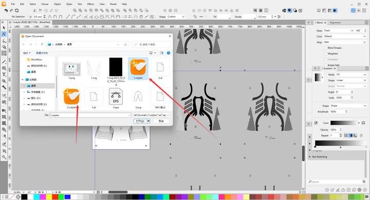

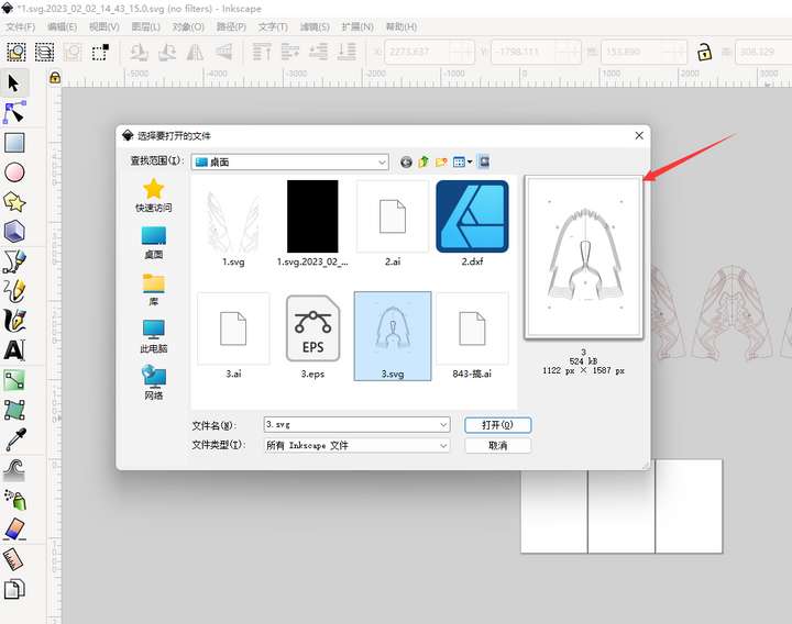

          @VectorStyler said in One Day Experience:
          Not clear how to replicate this. Is it opened in VectorStyler?
          For now, there is no other way to "preview" VectorStyler files, than opening it in VectorStyler.
          Question 1

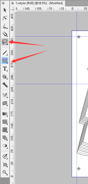

          Question 7
          Question 9
          I started to experience Inkscape in December and although it is not as powerful as VectorStyler, the features that are available in it basically support custom shortcuts, and the custom shortcuts are more than 85% inclusive, as everyone works in different environments and often uses different features, and if a software is to satisfy most people, it should have this level of inclusiveness. I hope VectorStyler becomes more powerful.

            @monsterfox Got it!
            About Question 1
            Yes, this is not yet supported in VectorStyler, neither on Windows nor on Mac.
            It is in the backlog, will be done sometime later.
            About Question 7
            This is actually a feature. The Lasso tool is a selection mode not a separate tool.
            This allows for example to have the Lasso tool active while using the Node editor tool so a lasso can be used for selection.
