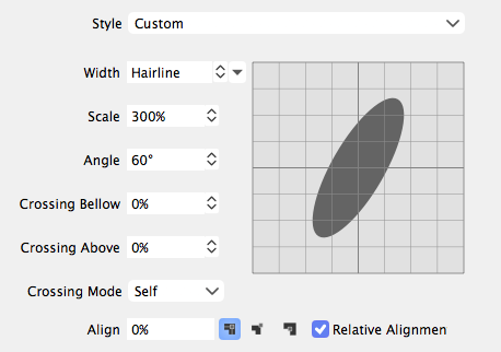

The Stroke Selector gives control over nib scale and angle, but the shape is always circular/elliptical.

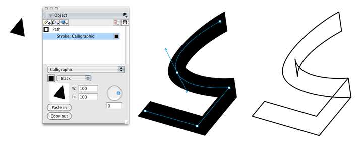

In the past I have done this in FreeHand as below.
The shape is pasted into a Calligraphic Stroke type, with controls for the colour, scaling and angle.
Triangles and rectangles work well.
It is a live effect (can be saved in a Style), but can be expanded, as shown at right in outline.In VS this might be done:

@Raven said in Arbitrary pen nib shape:
in the existing Stroke Attributes modals by adding a Shape chooser to the calligraphic Width and Angle section.
I think this would be the simplest and most efficient solution.

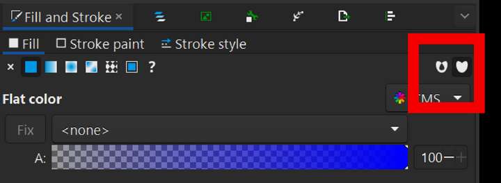

Inkscape has the option to remove "inner holes" - maybe something like that would help?

@Harry said in Arbitrary pen nib shape:
VS also has this option: "Winding Fill" in the Appearance panel, Fill row.
It does not help in this case.I add this feature to the long term feature list (v2 and after), some issues to solve:

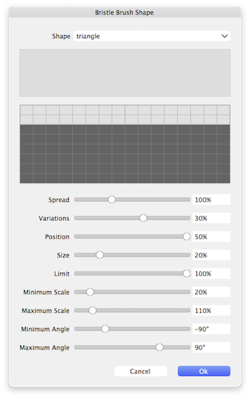

@Subpath - Thanks for the video. I've experimented with the Bristle brush you show, and it does give a calligraphic effect to the path width, but I can't see how to control the shape of the cap and corner beyond simple flat/round options. And for some reason it won't let me edit the shape in the Bristle Brush Shape window. The profile area is unresponsive and there is no preview, as shown here.
The underlying code is seemingly capable of sweeping a shape along a path, so the beginnings may be there.@Harry - Thinking further, I suspect the easier way to implement it would be as a type of vector brush, instead of modifying the basic stroke setting modal and having to deal with awkward interactions with stripe and dash, etc.

@Raven The bristle brush shape editor has a bug, fix will be in the next build.
