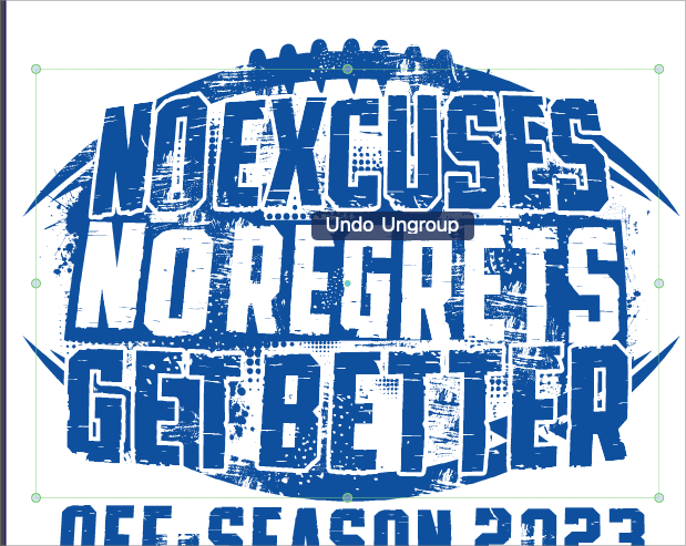

Is there a way to commit to a warp edit without having to use merge boolean to do so? I had grouped all the wording and distress around it inside the main american football shape and added a warp to it. When I went to ungroup, it altered the warp. If I merge it, VS will freeze because there are so many points.
@Boldline Convert to curve will do that.
I open a bug on the ungroup issue.
@VectorStyler ok I'll try that - thank you. I'll also try and replicate the other issue where ungrouping caused the warp to change and record a screen capture
