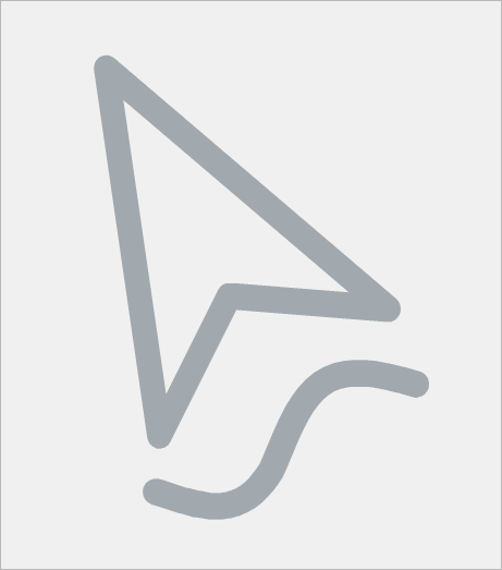

      I'm having trouble at times adding a new node to an existing path using the shape editor tool. I click twice and I get a cursor arrow with a squiggly line underneath. I tried many times to capture it including this video, but the screen capture was not showing it - so I drew it out . whatever setting I must have it on, it does not want me to easily add a node - it took several tries before it let me put on in successfully - sometimes it will add one in the center of the path between the existing buttressing nodes which was not intended.
      0_1671336127783_7d0ecd68-1f7d-4b7a-94d3-5570de6a686b-BLD 2022-12-17 at 23.01.59.png
        @Boldline This cursor is shown after the first click on a segment, and it indicates that an interior location along the segment is selected (this selection should be visible after a single click).
