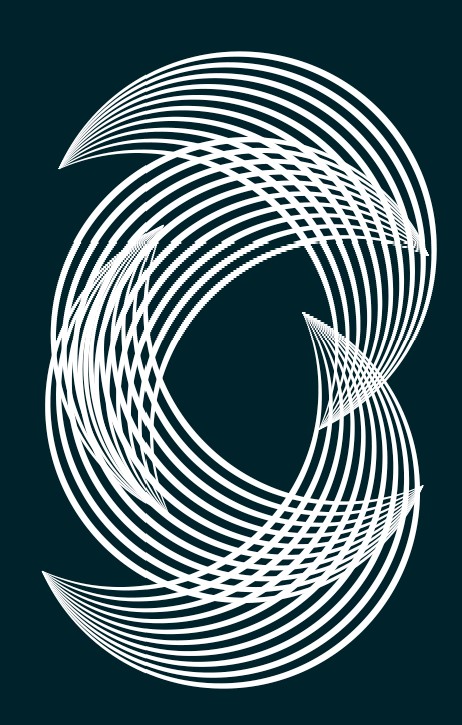

@VectorStyler Interesting shape. I can get this easily now that I dealt with blending:
but I can't get the final shape with the transform tool... I don't see how ? It can be of use but not what is expected.
@Pat The movement in the transform view has different implementation in VS and AI, so this will give different results.
I will try to improve this.
@VectorStyler I like the way VS handles objects transformation & maybe implementing an option to get the same transform than AI ?
@Pat I think the only issue here is how the movement is handled, and it should be easy to fix.

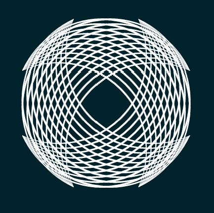

I got this, by grouping the finished blend which made it easier to rotate (from the center I think vs from an edge). Quite a bit of tinkering. Not a bad result.
Thanks for the help.
