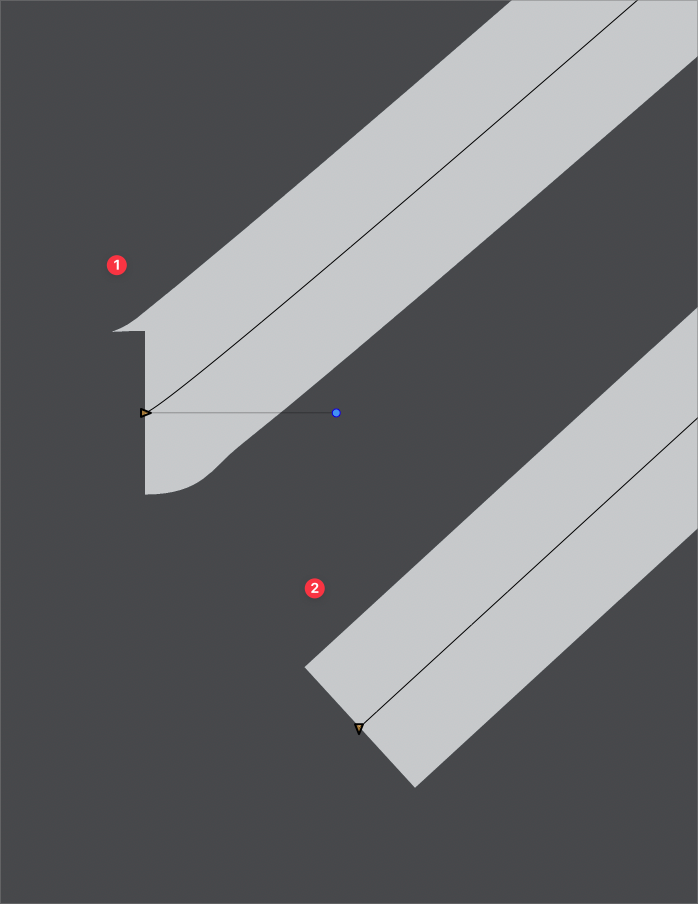

      On a related note, if I click too quickly with the pen tool to initiate a path, I get an unwanted result with the starting node cock-eyed with one handle visible. Is there a way to reduce the likelihood of this or just slowing down the initial pen use? #1 in the example is with a quick tap and go with the stylus and 32 is if i slow down and click deliberately to begin the path - both examples are with the stylus. The mouse seems to handle both options better and always has in my experience.
      0_1669836417611_4177c7fc-3055-458d-ba7e-7671f2cf68c3-BLD 2022-11-30 at 14.26.08.png
        I seem to notice to issue with the beginning node not starting flush occurs even when I'm not doing dramatic fast click and go.
        It's hard to fix the issue because just selecting the node and pressing "L" to make it a cusp node does not work and often the handle is not very far out from the initial node it's connected to, so you have to zoom in far to click on it and delete the handle to get the desired result.

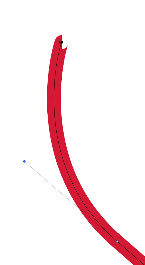

                With VS in the new build 71, I'm not having as many issues with uneven edges on the first point made like before - but it's still occasionally happening. The gray stroke example below is the occasional issue in VS with pen clicks pressed quickly.

                  @Boldline The problem here is that fast clicking results in short (or zero) handles. I will try to improve this, but it might be that in some cases the user wants short handles.
                  The stroke rendering artifacts are caused by these short handles.

                    If I can go a little further with this issue. I noticed that when I deleted a node on a path with a stroke rendering artifact- it would auto-correct the first node and left nearly the same identical path behind. This seemed to tell me that it was possible to not lose any path placement flexibility and still not have problematic beginning nodes with stroke rendering artifacts and still keep short handles 0_1671593439799_ed71d7ef-9e7a-4321-be8d-db095f3b43ec-BLD 2022-12-20 at 22.17.56.png

                    When I was experimenting in Designer for example, I never got a starting node that had stroke rendering artifacts - whether or not I pressed quickly. The stroke rendering artifacts can make it harder to connect fully the final point from the pen tool when closing a shape. Though this example was not the worst
