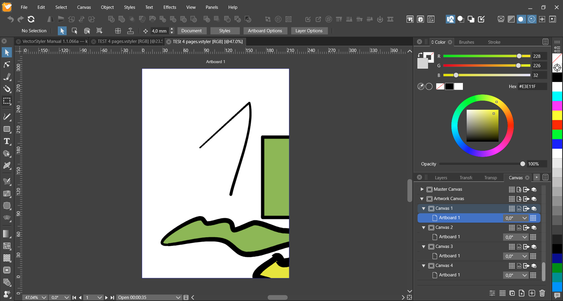

      But after exporting it to PDF, VS opens it on 4 separate canvases:

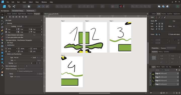

      My question is: how to open multi page PDF in VS on one canvas like on Affinity Designer:

        VectorStyler @Harry
        @Blunieb Curently, multipage PDFs are opened on different canvases (not artboards).
        A VS document can have multiple canvases, that are accessed from the Canvas&Artboard panels.
        Only one canvas is visible at a time, containing (possibly) multiple artboard.
        In case of PDF opening, you can find the other pages, on subsequent canvases (pagedown should also get there).

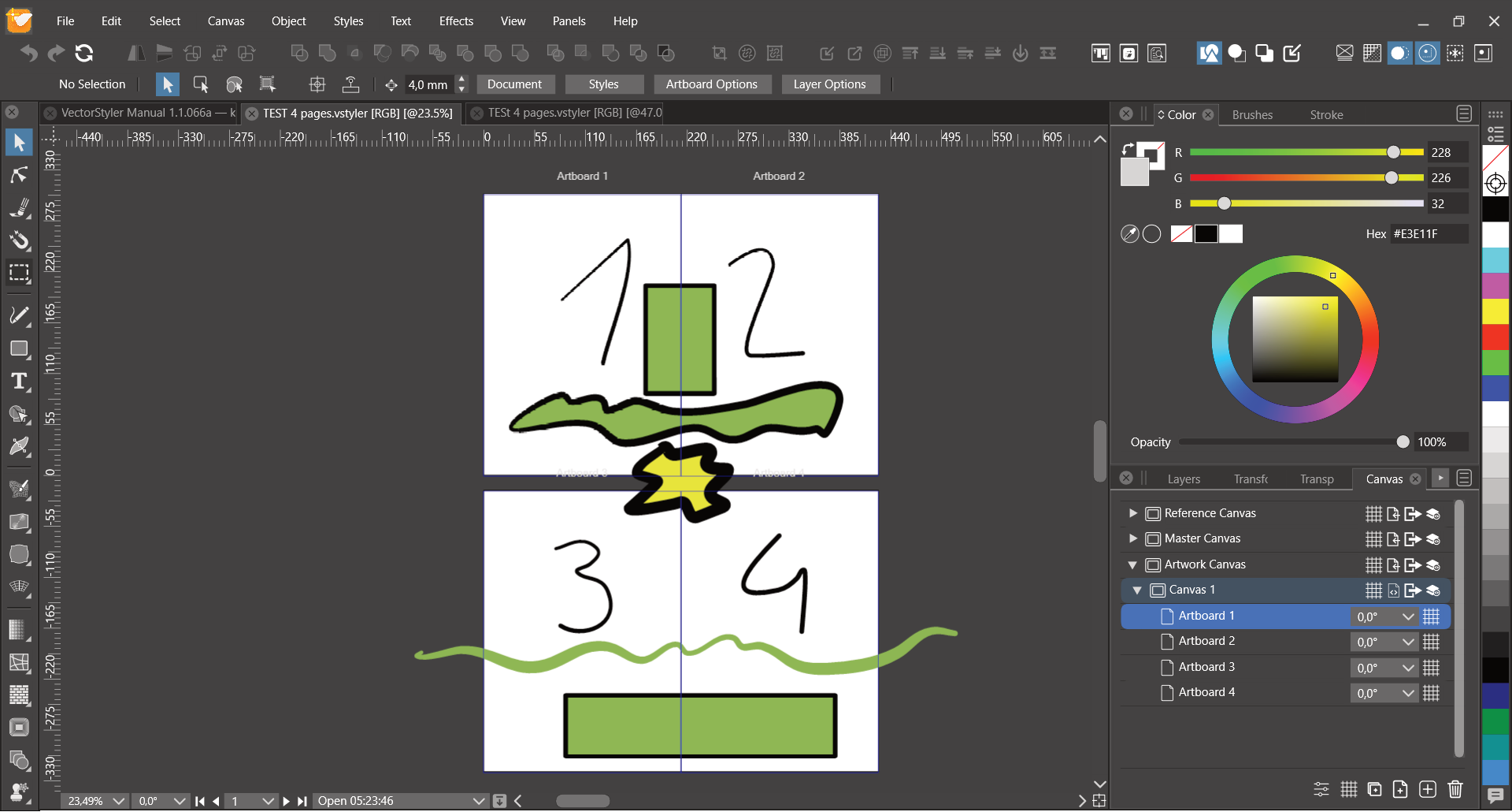

              Thank you for adding opening PDFs on one canvas in release 1.1.067 !

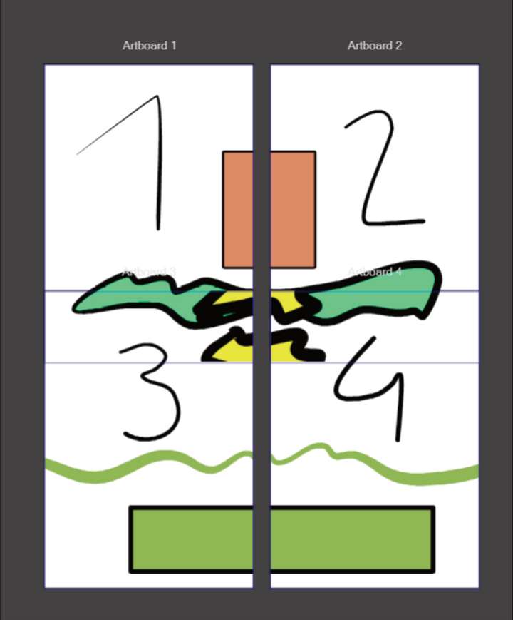

              But after opening my test pages, I got artboards overlapping:
              Also - after trying to open VS Manual (1339 PDF pages) - VS crashes. Build 066 was faster than Affinity Designer and didn't crash.

                As for the page overlaps, this could be a bug in the new part, and it might be that the page sizes are not fetched correctly from the PDF.
                I would need an example PDF to replicate this issue (send it to support at vectorstyler.com).

                    VectorStyler @Harry
                    @Harry Yes, pages are overlapped in this one.
                    I will try to fix this as soon as possible.
