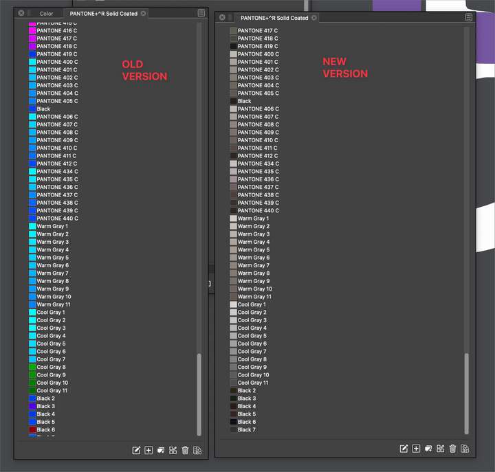

      I opened a pantone pallet file from Illustrator inside VS and it appears many of the colors are off. When I look at this list, all the cool grays are blues and greens, etc.

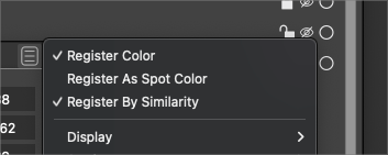

          @b77 I had opened it the first time as a supplemental palettes and the colors all seemed to be correct. I found the color I wanted to use and was trying to figure out how to add it to my main palette. I first tried double-clicking the color in the pantone palette, but that did not seem to work and instead brought the a color edit panel up. I had adjusted the "register color" settings and then was trying to go put them back when I lost track of the color I was looking for. I closed out the pantone palette and reopened it and the colors were all funky at that point.
          I have no doubt it was something dumb that i did, but if it was that easy to mess up and difficult to fix myself, I'm sure it will happen again to someone else

                @Boldline Yes, the problem can be replicated, and the fix has been found!
                ACB color palettes with Lab color format are not loaded correctly by VS.
                The fix will be in the next build.
                  @VectorStyler Amazing how fast you were able to fix the issue! thank you.
                  I'm also glad it was not just me making a silly mistake 🙂
                    @Boldline The only problem is that I cannot verify the fix. Illustrator 2019 and above will not open this ACB file.
                    I sent you an email with the converted palette.
                      Got your email and opened the file you sent - everything looks correct to me
                      0_1665059189485_aad67a8b-12ad-4113-bf50-5426d901a99d-BLD 2022-10-06 at 08.25.21.png
                        @Boldline This issue should be fixed in build 1.1.062
