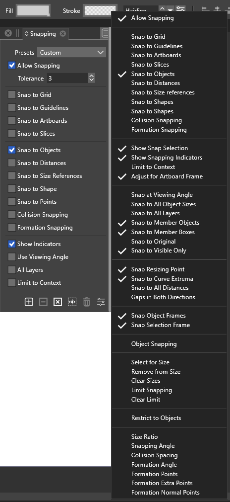

              Absolutely - I am trying to align the group as a whole - but I still get this indicator mess - and I have no idea what combination of these 50 settings I need to set for it to work like I prefer:
              alt text
              🍏 macOS Sequoia Apple Silicon

                    There is just too much happening on the screen and I am never sure it really aligns to what I want.
                    Snap object frames IS disabled in the above screenshot, and I simply gave up experimenting more.
                    Just too many advanced options. If they were all hidden now, and only unhidden one by one after user requests, I believe many of them would never appear again. (This just written to illustrate my point!!!)
