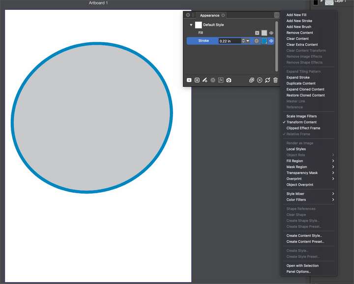

                      @vectoradmin Where do I find the new setting in build 20? This is what I see when I click on the panel menu when the stroke is selected in the appearance panel - did I miss it?

                        @Boldline I guess it was renamed to 'Scale Image Filters'.
                          Thanks @b77 I saw that option but it did not make sense to me and I had been looking for @vectoradmin 's title for it verbatim

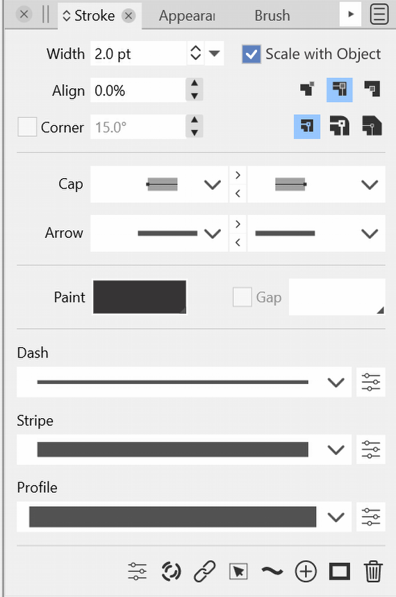

                                            I still think Transformed Stroke (scale stroke with object) needs to be more accessible rather than in a panel menu. Would it be helpful to also have it in the Stroke panel, next to the Width field?
