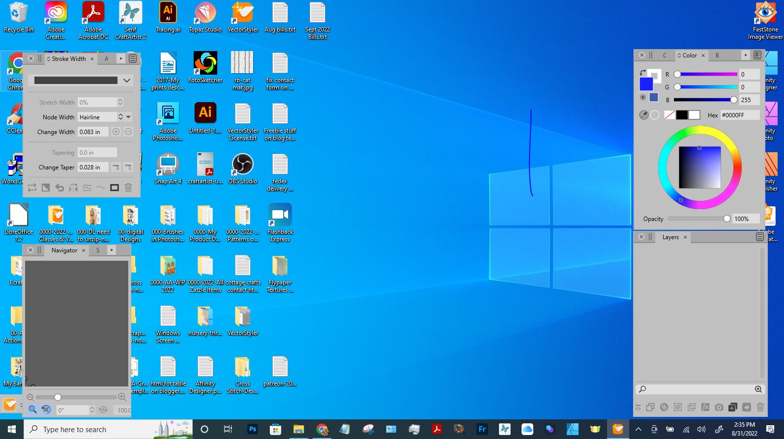

@SJStalter On the bottom left corner of the screenshot in the first post I see the VectorStyler window title icon.
It should not be that small, but can it be resized?EDIT: red circle around the possible VS window. But it should not be at that size.
Yes i found it. Yesterday the Navigator panel was covering the critical part. I've resized it and now have my program background. Thank you so much!
