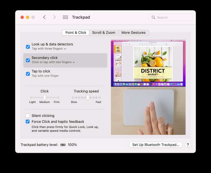

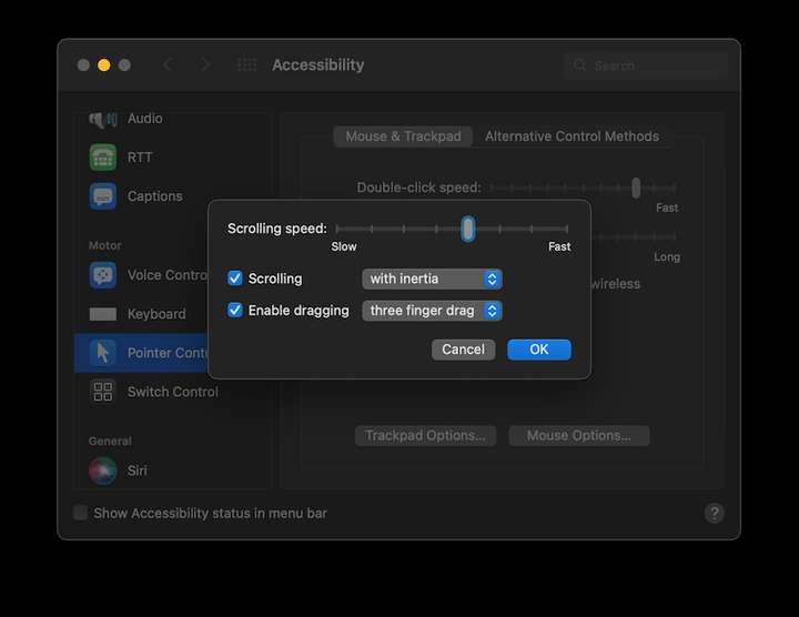

Is the BetterTouchTool or another similar app used to configure the trackpad on the M1 Mac mini?
No, I don't use any apps for configuring the trackpad.
@tudor So these are the settings in System Prefs?
Yes, that's correct. And on the Trackpad options, I have Tap-to-click enabled.
