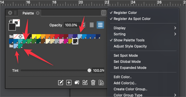

  • Is there a way VS could recognize that an existing color is already a spot color and bypass making another copy of that color in the palette menu? I love the feature that will turn any added color into a spot color, but if I use a color in the existing spot colors of the palette, it should not make a new one, it will just lead to confusion
    You can see in my example I used a teal spot color to change the artboard color and it made a new spot color for it - then I had used a light blue in the design initially, using the light blue existing spot color and it ended up making another.
    I sampled all the other colors in the design aside from the black from a photo reference I pulled in, but none of those became spot colors...

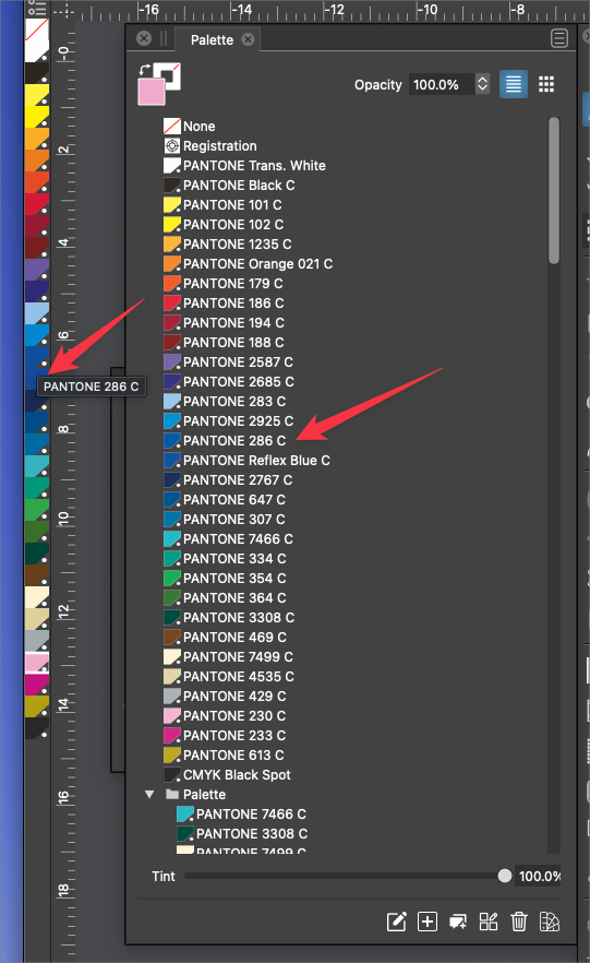

    If both the vertical color bar and the main color palette panel are using the exact same ase file, wouldn't both be using the same names for their respective colors? If I pick a blue 286C from the vertical color bar, why would that create a new 286 C blue swatch in the main color palette panel when there's already an identical blue 286C in there?
    In the screenshot below my (invisible) cursor is hovering over the Blue 286C in the vertical color bar palette and I'm showing the same ase file loaded as the main color palette in the document that has the exact same name - yet if I click on the vertical color bar version of 286C, it will create a new version of in the main color palette panel
    0_1659905090533_4de0dd46-531d-4377-a504-6d9a3e88c328-BLD 2022-08-07 at 16.41.43.png
    @Boldline It looks like the side-docked palette is different from the main document palette.
    In the side-docked palette menu, select Show Palette -> Palette to show the current document color palette.
    In this case extra colors will not be registered.
