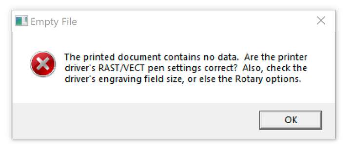

Here is the issue (there's no point in doing a video
If I create a similar file in the windows version of VS (within the emulator) then print to the laser, no problem.
If I open a file created in the Mac version (in the VS Win version) and then use the same printer settings, I get an error from the printer driver ...Now, if I use the same file and draw an object beside the original objects on the page - say a rectangle - then use (I) to copy and paste the original file item's attributes ( red 255 stroke 0.05mm and no fill)) - I can print the new rectangle to the laser - BUT, it doesn't print the original data on the file that sits beside it

@Igull said in Mac/Win File Swapping:
This is where the problem is. Do not use the same printer settings. The problem is that doing so, VS will try to reuse the printer settings found in the vstyler file (they are stored).
One way to get around this to print to a PDF/PS file (select PDF File or Postscript File in the Printer drop down), confirm the printing and confirm the file selection.
Then the printer settings are replaced to something that is portable between Mac/Windows.I opened a bug on this one: The printer settings stored in the vstyle file on one OS should not be reused on another OS.
I was trying to replicate this error, but could not.
What was the printer used on Windows?
If there is a file that results in this error when printing on Windows, please send it to me by email. It might help in replicating the error.
