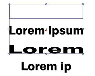

But a similar thing is possible in VS. The only issue is that the text will not keep its position (I opened a bug on this to try to improve).
Attached the example file for quick reference:0_1657209166453_textvariable.vstyler
What is in the file:
- the blue rectangle is a named shape reference (see Object Options and Role).
- the text has an Envelope effect.
- in the Envelope effect options, the shape reference is set as the envelope shape.
- editing the text will keep the size to the rectangle (because of the envelope).
- changing the rectangle will change the envelope size / proportions.

https://www.youtube.com/watch?v=v-cgkYhtiMEjust watched the video, that would be a great addition to VS. It would be great to be able to custom save a warp shape for future use like that. Although it does not keep the size of the warp box the same, you can go in and change text in a warp currently in VS

@Boldline said in Is the constant text field size available?:
It is already possible to save shape effect presets and styles, including envelope effects
