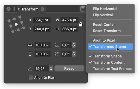

@Igull If I understand correctly, you need to enable the 'Transform Frame' option in the Transform panel's menu:

Great, thanks for that, Transformed Frame does the job - surprised that's not switched on by default ?

@VectorStyler Is this setting somewhere in Preferences and we can't find it?
@Igull When rotating an object, the width / height will be the object size before rotation. As mentioned, Reset Transform will restart the transformation values from default.
"Transformed Frame" is off by default because the width / height is intended to be the original size (for example images).
Convert to Curves will also reset all transformations and editable shape effects and bake it into curves.

OK, I can understand where you're coming from (just
), but in that case, the dimension should always remain constant and not flip-flop when mirrored and rotated ?

@Igull said in Width/Height not changing after object rotation:
), but in that case, the dimension should always remain constant and not flip-flop when mirrored and rotated ?When a rotated object is mirrored, the new transform (flipping) resets the previous transform. This resets the bounding box, which in turn now will show the new sizes.
OK, understood - I'm just happy that I can set it to my liking
