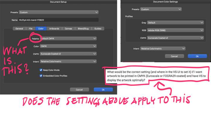

Thanks @ VectorStyler
- Can you please tell me:) if the settings on the screendump beneath applies to the requested color environment I stipulated?

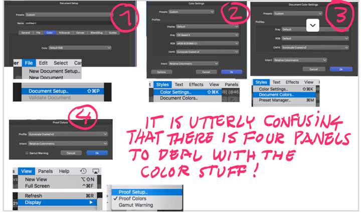

Also, I find the VS color management very confusing since I find four instances where one can add values ā proof setup included. The guide leaves no structured help:
https://www.vectorstyler.com/documentation/colors/settings/- Can you also (or anyone) give me a hint on which instances/panels in the UI I can stick to for achieving consistent color control?

@Raaskot I try to answer, in order of appearance:
The "Palette" drop down in Document Setup sets the default palette created with the document. This can be changed later. The colors in the palette can be generated (Default RGB/CMYK) or be picked from some other palette (including file). This concerns only the colors showing up in the palette, and can be set independently from the other color options.
In VS the color palette (known as swatches in other apps) is stored with the document.The "Document Color Settings" view can be used to override the color options set when creating the document (if for example the profile changes). Here you can set the Gray / RGB / CMYK color profiles.
Important to know: even if a document color mode is set to CMYK, the document may still contain gray or RGB colors, gradients, images. These need to be converted to CMYK for display, and this is done using the settings from "Document Color Settings" view.For an optimal CMYK workflow (and separation), set the color profile in Document Setup, no need to change anything in Document Color Settings, but in Styles -> Color Settings, set the display profile (btw: this also contains fallback color profile selection for gray / rgb / cmyk in case the document does not set that).
So once the CMYK and Display profiles are set, things should be working. An important thing to know about VS display of CMYK: the document is composited (rendered) into a CMYK (+alpha) image, and the resulting image is then converted from CMYK -> LAB -> Display RGB.
So all blend modes, opacity, composition, image effects, etc happen in CMYK mode. And this may result (obviously) in different colors if its done in RGB.Screenshot (1) "Document Setup": Here you can change the color (or other document level) settings of the document. Same as the New Document Setup, but in case the initial settings need to be changed.
Screenshot (2) "Color Settings": these are the "global" color settings of VS. This also contains Gray/RGB/CMYK profile selection, in case the document does not specify that (for example: Default CMYK). These settings are global and not stored in the document. The display profile is also here (since that is not needed to be stored with the document).
Screenshot (3) "Document Color Settings": these are the "local" color settings of the document. These are stored with the document.
Screenshot (4) "Proof Colors": this is a bit of an extra thing (but also in Illustrator), and concerns only documents in RGB mode (not applicable for CMYK), and it is used to set a CMYK profile to proof (view) an RGB color document. Again, this has no use for CMYK document (neither the gamut, or Proof Colors from the same menu).
I think, in one form or other the above 4 options are also available in Illustrator,.
