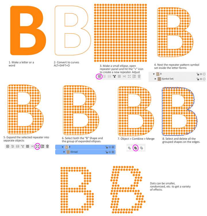

              I was fascinated by this question and it got me thinking about all the tools and ways to approach this problem. Here is my stab at it with just using an array of shapes with the Repeater function. Much more uniform and less organic than the effect you illustrate above, but it has potential.
              I was especially focused on how to create dots that are not cut by the boundary of the letter form, which is what makes your question, based on the example, a real challenge. Otherwise it can be handled easily with a pattern as a fill, or the "cut off" dots in the nested letter can be manually deleted; but that is a bit tedious.
              So here is a solution that requires only a few deletions, making it a viable choice, in my opinion. Thanks for asking the question and presenting the challenge.

                  Subpath @Victor Vector
                  @Victor-Vector
                  nice try, but as you see
                  the circles dont follow the shape
                  in Repeater
                  Victor VectorV 1 Reply Last reply Reply Quote 0
                  • Victor VectorV Offline
                    Victor Vector @Subpath
                    @Subpath said in How to create letters made of circles?:
                    @Victor-Vector
                    in Repeater
                    Yes, I know that. I was offering a possible solution to "letters made of circles" not "letters made of circles that follow the flow of a hand written script", thinking that one might be trying to create the effect with a typeface that was not analogous to handwriting.
