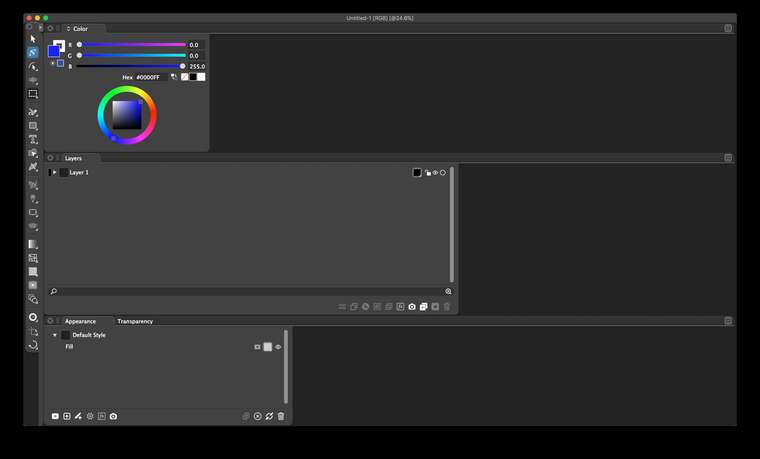

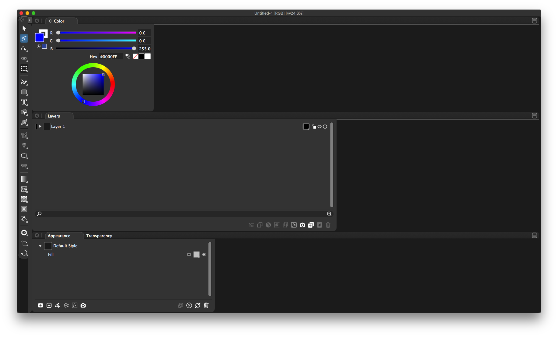

      I've noticed over the last couple beta versions, when I go to open VS for the first time. All the panels and boxes are shifted to the left side because there is no open document. But even when I go and create one, I still have to manually rearrange the layout, or go in and reset the workspace under Vectorstyler>Workspaces
      Is this a bug or did I need to do something to fix this on my end? thanks!
