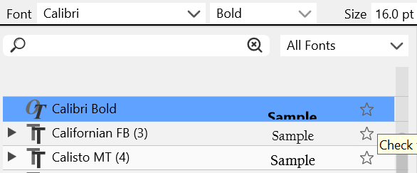

      The ubiquitous Windows font family, Calibri, is installed on my system with 6 fonts, yet only one font, bold, shows up in the VS interface.
      The expected behaviour is to see all 6 fonts in the interface with a drop-down arrow beside the font family name. A quick check in Affinity Designer reveals all 6 fonts are present.
      I only checked Calibri for this issue. It could be on other font families, but I have not verified any others.

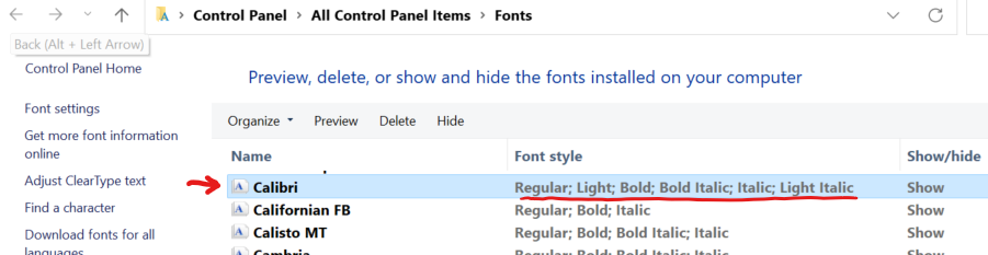

      Windows 11 Installed fonts:
      VectorStyler:

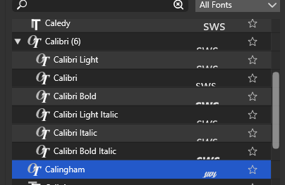

        Build 036 but on Win10. Works fine.
          VectorStyler @Victor Vector
          @Victor-Vector Tried this on Windows 10 and it works fine.

          What is the location (folder) where the Windows 11 fonts are installed?

            @vectoradmin Selecting "Installed Fonts" fixed it so I can see all six installed fonts in the font family. Why does it not display them when "All Fonts" is selected?
            The fonts are installed/reside in C:/Windows/Fonts. The folder is hidden.
            Thanks.
              @Victor-Vector Looks like a bug, it can also be replicated here.
