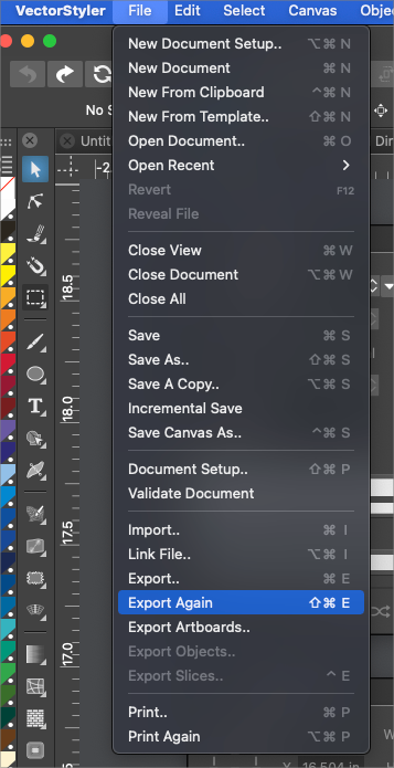

"Export Again" option to save as new exported file instead of copying over?
  • I had a vector design I needed to export as two distinct png files using different colors in each. I used the export option and everything went well. I then swapped the ink color in the design and clicked on "export again" thinking it would use the same settings as before and create a second file perhaps with the same title and a (1) at the end so it was different than the first.
    Instead I realized it actually saved over the first exported file. I can see both instances being useful - the ability to quickly export a file and then go in and make edits and export again expecting to get multiple variation results or expecting the file to be replaced each time you edit.
    0_1649960664610_3a2ef26b-3fb2-46f2-a8f4-54da4fdd5726-BLD 2022-04-14 at 14.24.10.png
  • @Boldline If you need versions in different colors, why not duplicate the artboard with the artwork, change the ink color and use 'Export Artboards…' instead.
  • @b77 ok - good idea. Where is the option to duplicate artboard? I did not see it when I went looking - thanks!
  • @Boldline Just Option-drag any artboard with the Artboard Editor tool (Shift-O), and also press Shift to constrain the duplication horizontally or vertically.
  • @b77 Thanks! you learn a new thing every day. Is that shortcut noted in the documentation? I didn't see it when I was going through artboard options
  • @Boldline It's the same method used to duplicate objects. Indeed it's not included in the Shortcuts table. Maybe it should. đź‘Ť
  • @b77 Now that you mention how it works, it makes sense and I will not forget it, but on my own I would not have equated copying the artboard as the same kind of function as copying an object. So I feel it should be included in the documentation in the shortcuts table section for sure - maybe even the artboard section
